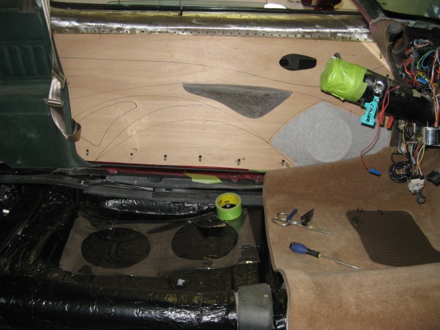

I personally just use the hush-mat. Then normal carpet pad and carpet. Have no fit issues, it deadens sound and heat. Plus its just peel and stick. I prefer the black over the silver face. It holds glue better for carpet and does not show if you go up fire walls and such as much as the silver does.
Here you can see where I stopped it going from floor up back seat area.
[img]
If you put to much pad under carpet then the tracks don't like to move and end up wearing groves in carpet is what I have found. The Hush mat makes a big difference.
Here is the floor with carpet that came with carpet pad.
[img]
[img]
![Sound deadener Img_3811](https://i.servimg.com/u/f14/17/24/85/08/img_3811.jpg)
[img]
![Sound deadener Img_3812](https://i.servimg.com/u/f14/17/24/85/08/img_3812.jpg)

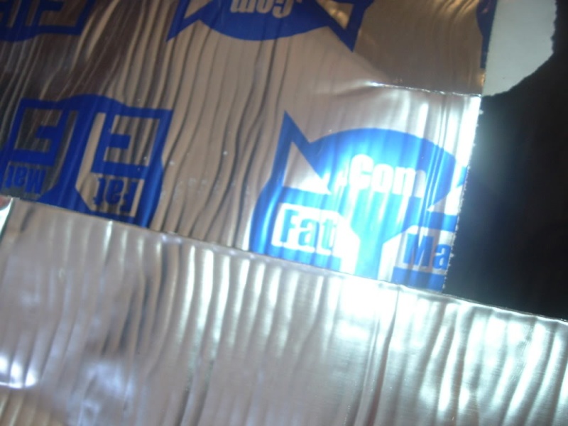

Pulled this from another forum Sam turned me on to. I think I will go with it. Guy said it took 3 rolls for his car floor/doors. $11 a roll.
![Sound deadener Dscf3610](https://i.servimg.com/u/f13/17/24/43/31/dscf3610.jpg)
![Sound deadener 24691910](https://i.servimg.com/u/f13/17/24/43/31/24691910.jpg)
