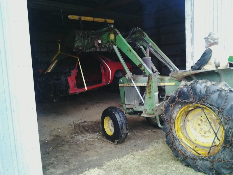

Post by Hawk03 Sun Apr 28, 2013 7:08 pm
I was finally able to work on the car. My dad started taking things off and I finished it and then we lifted the body off the frame. Next will be cleaning the frame and tidying up the engine and transmission.
Body Swap 2013-010
Body Swap 2013-011
Body Swap 2013-012
Street Cred : 18
Body Swap Empty Re: Body Swap
Post by Limey SE Sun Apr 28, 2013 8:10 pm
Ok Maybe a stupid question are you re-using the front,rear and side Glass ?
And all the chrome related to it ??
Post by 77mali Sun Apr 28, 2013 8:15 pm
Damn I wish I had a tractor Very Happy
