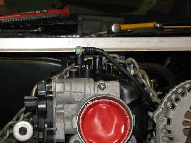

If you do the truck swap the intake will not clear your hood with dirty dingo mounts unless you eliminate the A/C. That means swamping out intake and then water pump and possibly all front components. That can add up fast so a car set up will be the best way to go but they do coat more to start with.
I have a shaker whole in my hood when I got this car so I will be making the shaker scoop fit.
Here is a photo of the clearance with keeping every thing stock form a truck engine.
[url=
This is a piece of angle iron laid across tops of fenders. I can not go any lower as oil pan would hit cross member.
[url=
![G3 LS1 Swap Img_6610](https://i.servimg.com/u/f77/17/24/85/08/img_6610.jpg)
