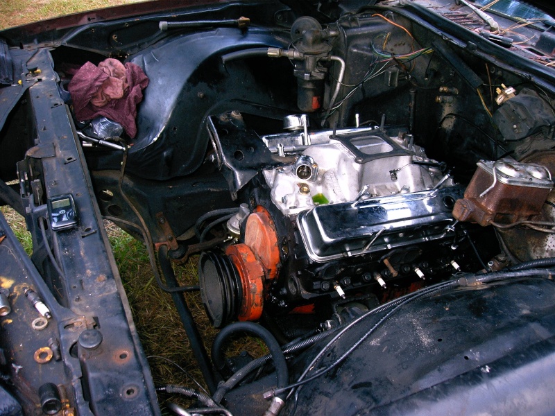

on a side note here are some pics from the work ive been doing on it

sense im not working i took this week to work on the car got tired of craigslist idiots calling me to buy the car then low balling me so I decided to just fix it and deal with this than the idiots on there,
gonna pull the motor out check block # and see what flywheel i have, gonna get a new waterpump cause mine is all rusty and ugly, maybe get a cam, new timing chain double roller, and paint it black.

got the motor pulled and guess what flywheel is cracked and missing teeth...hmmm i wonder how this happened

Funny thing...I was going to suggest looking for a cracked flywheel. Had a '93 Explorer that went through two of them in less than 100K miles and the symptoms were very similar to yours; except mine would make a screeching noise as the starter gear tried to engage the flywheel. First one cracked at about 34K (covered under warranty). Dealership couldn't offer any explanation why it was chewing through flywheels other than something might have been slightly out of balance within the engine.

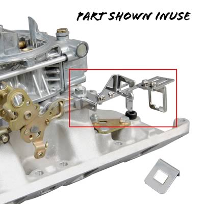

maybe im just missing something but my bracket for the cable isnt going in..help>

Don't quote me on this, but I think that bracket is for the transmission kickdown cable. That bracket sits too low against the intake manifold to be for the throttle cable. Unfortunately when using an aftermarket carb. the factory cable support brackets rarely fit the new carb. correctly.

it fit before we took the motor out, but it is the bracket that holds the throttle cable to the carb

[img]
[/img] It looks as though your throttle cable was force fitted into the bracket you show. Your local auto supply store should have one of these you can use.

You should have 2 slots, one for trans cable & the other is the throttle. Â You have a different looking bracket, is that a 4bbl carb?
Edelbrock has these in vortec version & non they might also be avail @ your local parts stores. Â Non vortec is #8031.

mine is a 4 Barrel edelbrock, but see it was on the car when i put the new carb and intake on it and fit just fine. So all of a sudden its not?

Is the new intake a lot different than your old one? That factory bracket might be specific to the old manifold. I snagged a vortec bracket off of a early 90's truck hoping it would fit my manifold but I was "S.O.L".

Yeah i fixed it, found i put it in the wrong spot hahah
