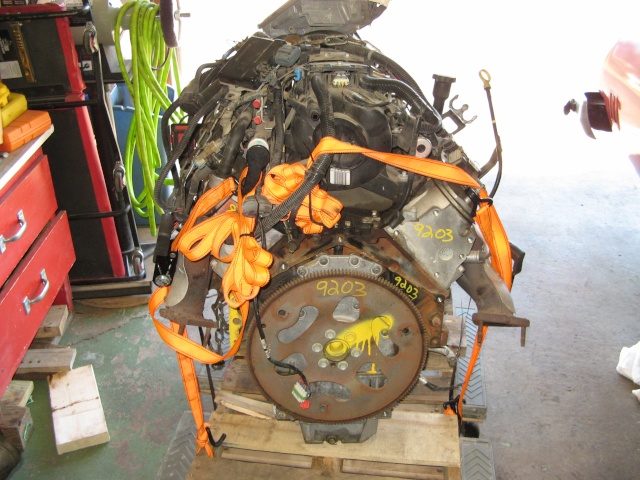

Just testing the LSx fit. It should be fine with the Truck oil pan. I just need a normal intake.

Earlier you said LS1 but I see an iron block. What engine is it?

Its a truck motor. Not sure what they are technically called. LSx? Its gonna get a better intake, headwork and a nice cam. It will be an LS-phil. Uh the lobster pot was for pasta when I was a kid. I swiped it from Mom 30 ish years ago.

4.8? 5.3? 6.0? Do you know the year? What heads are on it?

May be this will help you in your question. Mine in photos below it out of a 2003 chevy Tahoe. Its a 5.3 what they call a drop out or take/lift out. It is a iron block with Aluminum heads. I have no clue what "LS it is" If you are looking to do one you will want every thing with it uncut harness and all. Mine is a drive by wire so you would need the gas pedal also.

Maybe I can help you both.. Â In your case, Wally you just say it's a 5.3. Â "LS1" isn't a generalized term. Â It's the aluminum block 5.7. Â Any time someone says LS and a number, they should mean a specific aluminum blocked engine. Â The truck engines have so many variations through the years that unless you really know what you have you just say displacement. Â I have an LQ4 6.0 in my Chevelle and my buddy has a factory flat top piston LQ9 6.0 going in his 78 Chevy truck. Â The only difference is pistons and compression. Â
If either of you have opened your engines up, generally a 5.3 will have dished pistons and a 4.8 will have flat tops. There are occasions where that's not true buuuut.. You can also pull the oil pan to check the part number on the crank. 4.8s have a shorter stroke crank than the rest of the truck engines. They put both a 4.8 and a 5.3 in half ton trucks so you have to do some investigating to find out what the donor has. The easiest way is to check the VIN but I can't remember which way it goes so I'll have to look that up again.
All LS engines share a majority of parts. Almost all have aluminum heads except the very first 6.0s and they're junk.
Hope this helps everyone.
