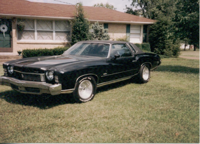

This is the car I started with. Full optioned minus the sunroof.

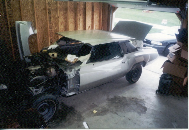

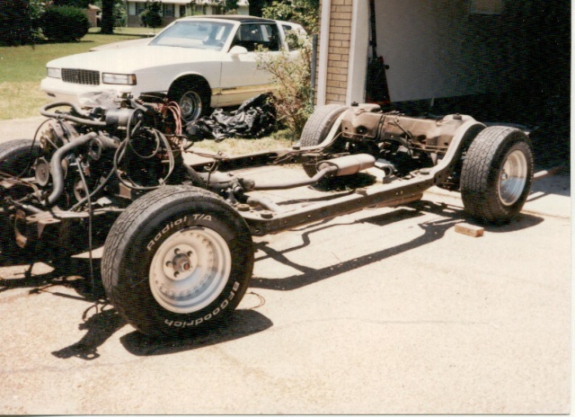

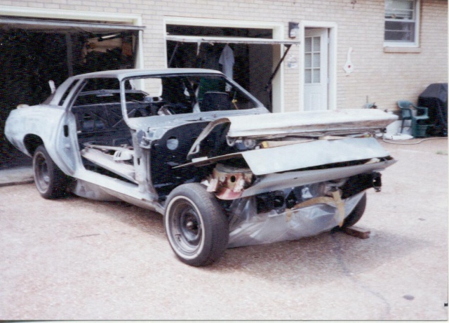

So , once the body was off the frame. I could start the chassis. Sandblasted all frame related hard parts.

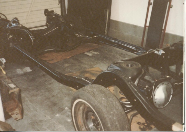

Then the rebuild began. Coated everyting with POR-15 through a remote spray pot. At this point the rearend had been totally rebuilt with a Auburn Pos. added with 3.42 gears. PST polygraphite bushing throughout. Stainless hard brake lines. Springs, sway bars , etc. painted a different color for detail.
Then , I wanted to run stainless throught the car. Only one problem. At the time , no companies were offering stainless fuel lines from the motor to the tank. So , I talked to the owner of Classic Tube and he said he didnt have any but would like to find some clean specimens to make patterns and offer those for sales in the future for owners of our cars. During the conversation , I told him I may have what he needed to make that happen. I sent mine to him he made patterns and he only charged me for the materials.

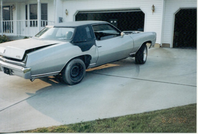

At this point , I was ready to start on the body. But , once I got into it , I found a lot of rust in the area around the opera windows and the dog-leg around the rear window being a Tennessee car all its life and not sheltered. I call got in touch with an individual in Colorado that had a set of quarters specially for the 73 as NOS. But , what he wanted for them was not appealing ! There had to be a better way !!

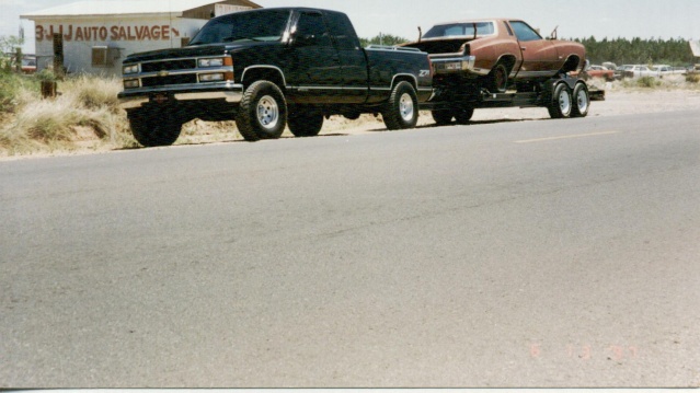

So my search went out west . With a Hemmings magazine I started calling junkyards out west. If one guy didnt have one...he had a buddy that had junkyard. So after two weeks of searching I found one in New Mexico. I sent a disposable camera to the owner of the junkyard and asked that he take specific pictures in specific areas. He did and it revealed a totally rust free car. We agreed on the price and went to pick it up. That a story in its self. Some good together time for me and my brother as adults.

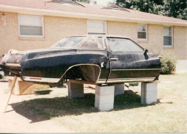

Got the car back to Tennessee and started the process of stripping the body and then transferring it onto the newly built chassis. I found the build sheet of the desert car. Built full optioned in Fremont California. Per the build sheet. It was a Fleet Executive car. Has the designation typed on the build sheet.
I got lucky. When I got the body down to metal. No prior work had ever been performed on the car nor could I find evidence of where the car had been wacked. So I coated the complete interior with the POR-15. Under the body. Trunk. I taped off the area where the Vinyl roof is to go back on as this was a solid car and didnt want the possibility of rust to start in those areas that are prevalent on our cars. Matter of fact, early in its life someone had removed the vinyl roof which I believe saved it ! But , I wanted the vinyl back on...I think our cars look better with it. Without it....it is like a suit with the wrong shoes ! Extra doors and fenders left over from the desert car in these pics.

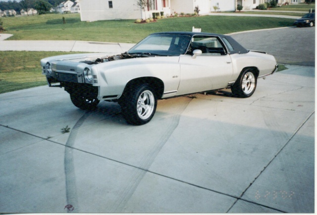

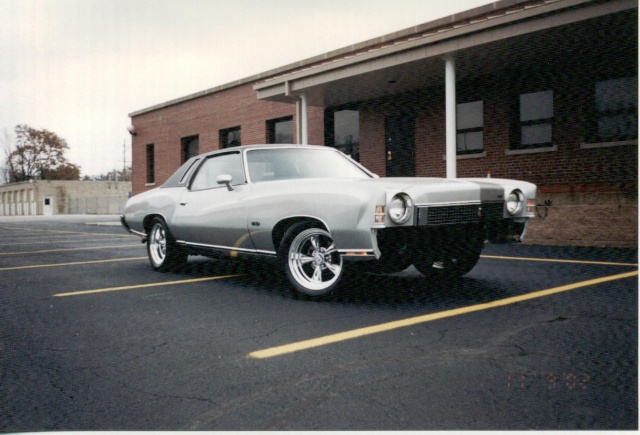

From there I had the car painted. 1996 Camaro Sebring Silver Metallic.I have painted several cars but I knew that with this I would not be able to achieve the results I wanted. I had very little knowledge of the two step process of water based base coat / clear coat. Better left to a man that has had 30 years with a spray gun in his hand. Left up to me...I would spent as much on materials repainting and repainting again to get it the way I wanted. I feel I was money ahead to pay someone with the high cost of materials the way they are now.

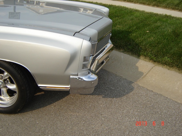

Most of the chrome on the car is NOS. (85%) Years of accumulation. When I found parts in the original wrappers...I bought them.
Now with a bumper tuck...

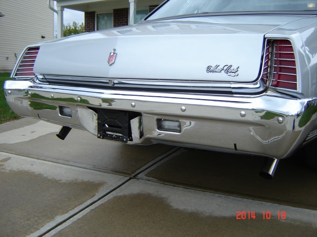

Yes, beautiful car. What brand exhaust is that? And if you look under the rear of the car, can you see the mufflers lower than the axle?? thanks
- Street Cred : 80
Re: Update :1973 Monte Carlo Body off frame resto. Now with LS!
The exhaust system is a Magnaflow for our cars. It does need some messaging to go in. And , I have Hedman mid-length headers. I installed the Mid-length because I did not want to drag full length units as I plan to go down another inch on the suspension.
You can not see the mufflers below the axle. Looks that way due to angle of picture. But , once you get them in you wish everybody could as they are mirror finish stainless.

Cool. Thanks for the info. I dont like when you can see the mufflers from the back view. Are those mufflers "center out"? Any idea of the magnaflow kit number? Thanks
- Street Cred : 80
1973montec- Donating Member
2.5" Center out. Kit 15894.

I had my taillight bezels re-chromed and have recently installed them along with my NOS rear bumper.
