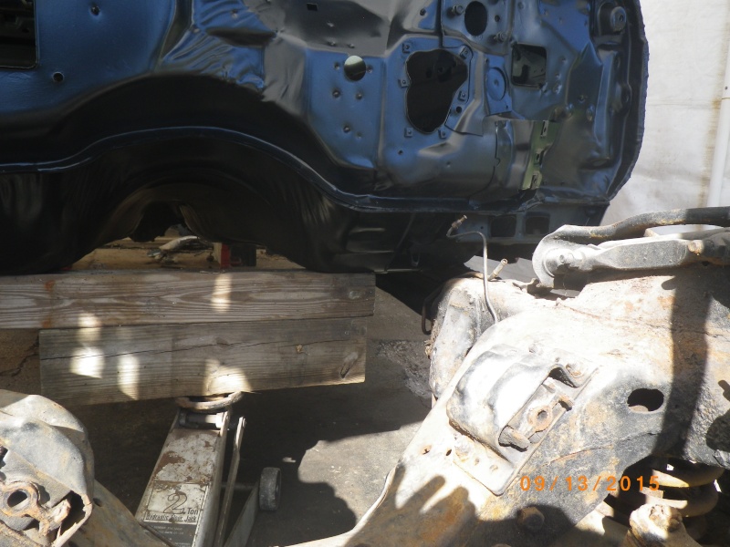

ok no picture of it yet but I Herculined the floor and inside the smuggler box. then moved on to remove the frame
just used some 4x4's, cinder blocks, and a couple of floor jacks, mostly just one jack.
yanked it out using the drums as rollers which worked really well and gave more clearance for it to slide under
so now im selling a solid 1977 Georgia El Camino rolling chassis
just gotta clean the spots that the frame was in the way of before and then I can drop the body on the frame that I already finished.

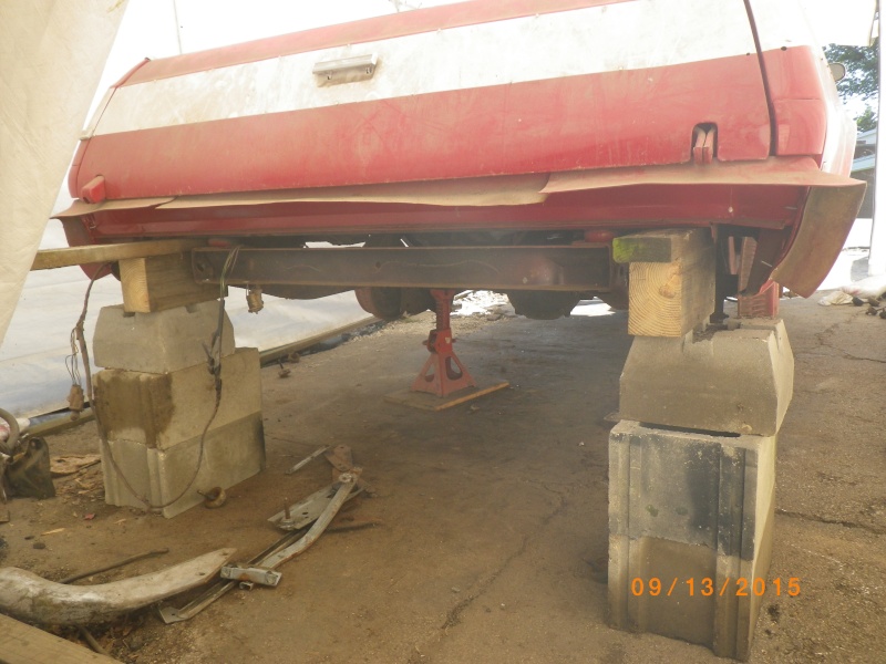

ok got her back down on the rightful frame with a few hands.
and got the other wheel well painted

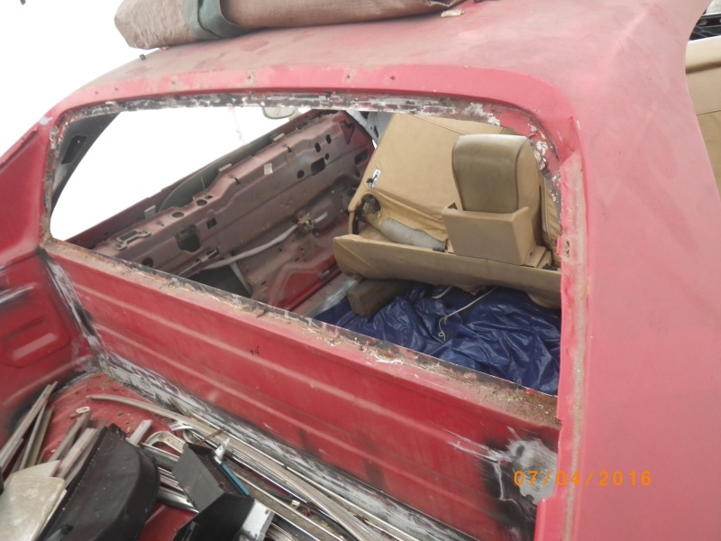

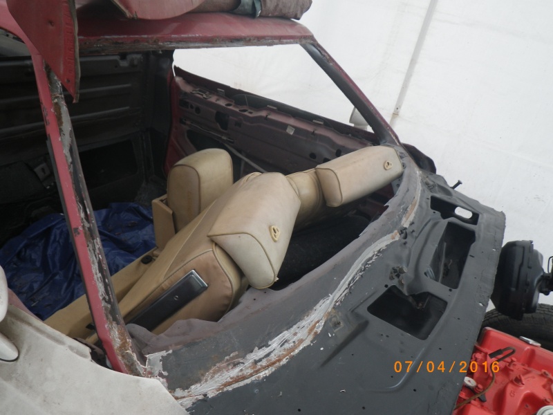

then spent a day removing the rest of the useful parts from the other body, and took it down to handlable pieces so I can take it to the scrap yard
before
middle
after
before
middle
after

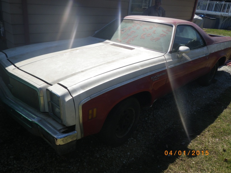

havent done too much yet, waiting on weather and time. but I'm planning on painting it myself, 2 tone, antique white and dark green metallic.
white whats white and green whats red not picture of actual stage, just a visual aid.
does anyone have suggestions of paint brand and type to go with keeping in mind Im not a professional painter but good at learning things.

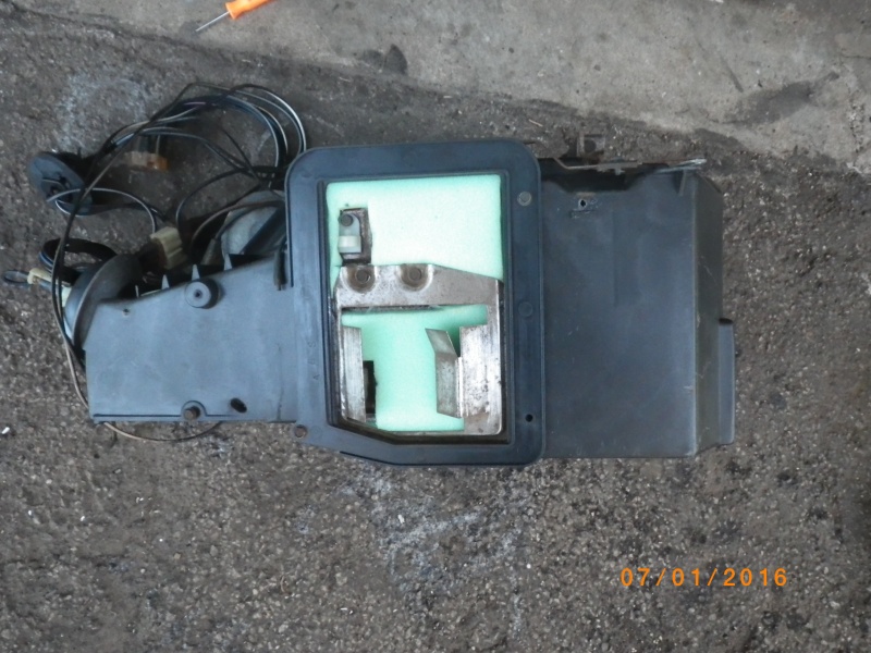

ok got some done nothing big unfortunately, got the heater box cleaned and rebuilt with new foam from joann fabrics,
removed the front windshield that nwas cracked and made it cracked more, took out the rear window in one piece no problem
