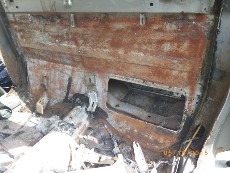

Post by riddick75 Sun May 10, 2015 11:32 pm
started cleaning the floor pans, found a little more bondo than I bargained forbut for the most part it looks like he used it to smooth the panels out for some reason.
75 el camino project.  - Page 3 Imgp2110
so bondo ground out and also pulled the dash out and everything else I could.
75 el camino project.  - Page 3 Imgp2112
75 el camino project.  - Page 3 Imgp2111
some holes in the floor that will be addressed and some in the rear wall
75 el camino project.  - Page 3 Imgp2113
so next step is the smugglers box to come off to do the cleaning and patching.

Post by thatfnthing Mon May 11, 2015 8:44 am
Those floors are actually in pretty decent shape.
75 el camino project.  - Page 3 Empty Re: 75 el camino project.
Post by riddick75 Mon May 11, 2015 11:50 am
Yea they are in good shape. still gotta get under it and see how things are but the worst part is the driver rear Thats a little swiss cheese but I'm thinking of forming a little metal over and patching in. Don't see the sense of buying a floor pan section for any of it really. And the back wall has some spots that Ill probably be able to just plug weld them shut. But over all really solid.

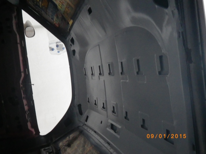

Post by riddick75 Thu Sep 03, 2015 4:55 pm
ok its been a while since I posted between work, work, and working on the car. but here it is up to date
75 el camino project.  - Page 3 Imgp2510
back wall patched in and seam sealed
75 el camino project.  - Page 3 Imgp2610
roof with some surface rust
75 el camino project.  - Page 3 Imgp2611
roof cleaning process (wire wheel and believe it or not, vinegar mixed with water) cleaned right down to metal.
75 el camino project.  - Page 3 Imgp2612
painted, rustolium white because its what I had lying around.
75 el camino project.  - Page 3 Imgp2710
floor to match, ill actually be using the truck bed liner paint just to give that added waterproof and a little sound deadening quality
75 el camino project.  - Page 3 Imgp2711
fire wall painted satin black, came out really well
75 el camino project.  - Page 3 Imgp2613
