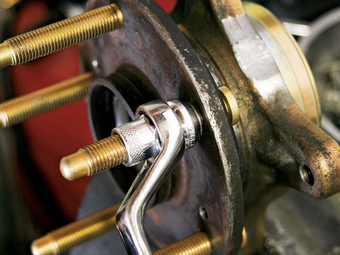

Have these style wrenches? Â Good to have a set for odd ball stuff like that.
