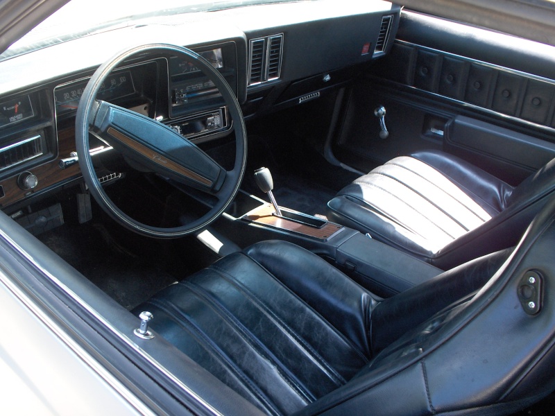

When I got it...All original 77 malibu classic with a 305 2bbl. 78,000 miles. Heat, a/c, cruise control, swivel seats...very nice cruiser. He also included everything to clone it into a Laguna. Front nose, window louvers, rear tail lights and tail light panel, and all the correct s-3 badges.

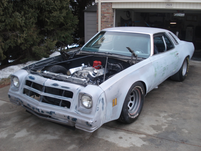

Just got motor dropped in. yes, that's snow outside. lol

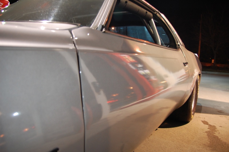

The reflection off my cheap $225 single stage DIY paint job through my fiberglass doors.

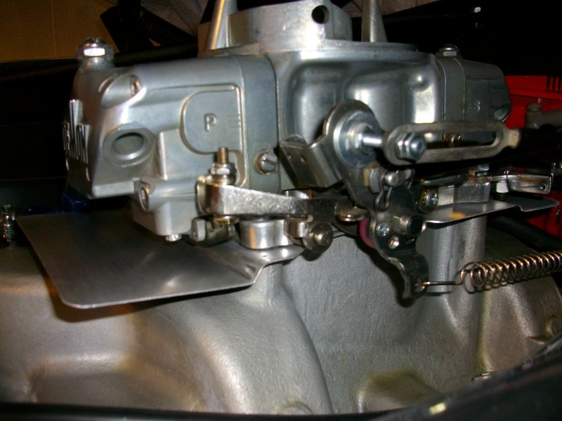

was having issues with the carb bowls getting hot and the car acting sluggish off idle. So made my own heat shield out of some scrap aluminum I had laying around. This is the cardboard template.
Oldschool454- G3GM Member
Re: Nascar inspired S-3 project
put a little step in it for pump arm clearance, and bam. No more stumble off idle.
