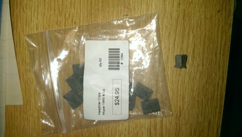

And here are the Mopar headliner clips I bought off eBay . They work good. They have a lead in that makes them easier to install. I hope they retain the finish trim satisfactorily. The stock seat cover used 29 clips. I ended up using 45 total to try to take out as many wrinkles as I could.

Good news on the Mopar clips, they work great with the edge trim!
I still need to address where the upholstery piping of the headrest meets the edge trim, I'm guessing it needs to tuck under the edge trim but stuff was really tight in that transition zone and I left it as-is for now. and of course the extra upholstery material sticking out from behind the edge trim can be seen.
