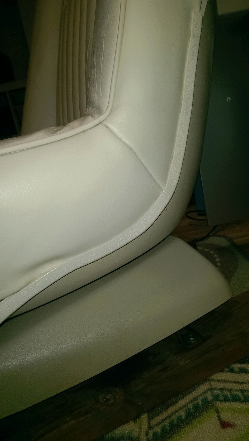

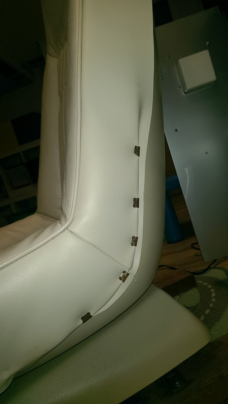

clanceman427 wrote:Quick question:..when attaching the edge of the vinyl seat cover where it meets the metal edge of the seat back frame, do you just take the vinyl to the edge, like in the first photo, or do you wrap the vinyl around the metal edge like in the 2nd photo? Just trying to imagine the best way to get the trim piece to cover the vinyl and the plastic seat back edge with the metal frame.edge in the middle. Its different now since the new trim is not sewed to the seat cover like factory. Which way did you guys do it?
When in doubt wrap as much as possible. Are you talking about where the pinch welt goes on the back its self. They used to have little metal clips that held the vinyl cover in place until you put the pinch welt on over the clip and vinyl.
Re: Where to purchase seat covers
Oh I think I understand. So during assembly, wrap the vinyl around the metal edge of the seat core, clip the vinyl with the metal clips, and then the pinch welt snaps over the already-clipped vinyl, and over the edge of the plastic seat back?
clanceman427- G3GM Enthusiast
clanceman427 wrote:Oh I think I understand. So during assembly, wrap the vinyl around the metal edge of the seat core, clip the vinyl with the metal clips, and then the pinch welt snaps over the already-clipped vinyl, and over the edge of the plastic seat back?
Correct but no one makes the little clips any more. You have to save the old ones and they like to stick inside old pinch welt.
You can use some spray glue on the inside edge to help hold cover on then put on pinch welt.

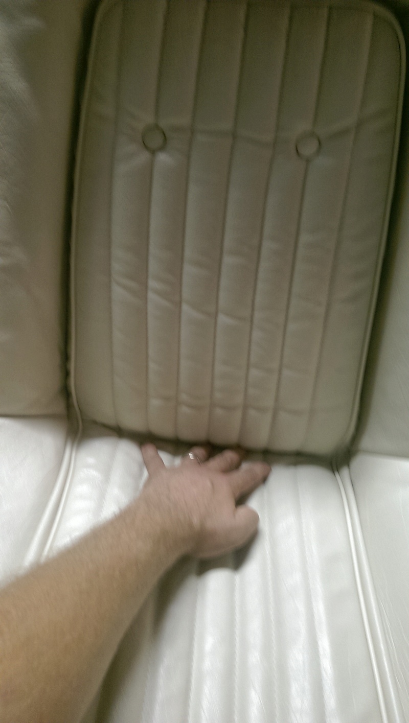

2 quick questions: when you added the extra foam on the seat back, did you also add it to the seat bottom as well? Was wondering that before I hog ring the bottom.
Also, did you guys hog ring the bottom back horizontal where the seat bottom and back meet? My factory covers were not hog ringed originally across there, but should I now to try and tidy up that area and pull the seat back insert wrinkles out? The area in question is where my fingers are pointing in the picture. Thanks
I only added foam to the top of the seat as they were sewn with more material than the factory covers. The first place you use hog rings is where your hand is located. That centers the seat cover properly. I did the bottom first then worked my way up to the top making sure all the slack/wrinkles was taken out as I went along.

Oh wow. See I started at hog ringing across the very top after first looping the headrest of the cover over the frame. Then down both sides of the seat back from the top, and then stopped where I took that photo. Obviously I didn't successfully get all the horizontal wrinkles out, despite using tons of steam. I'm gonna stop, remove my hog rings and redo it your way. When you got to the top, I guess your last set of hog rings that you installed were across the top at the headrest with the headrest material folded and then you looped the material over the headrest frame?
Yes, that's correct. The top of the cover should be inside out until you are ready to to work that part over the top of the metal seat frame. Just be very careful at that point when you turn it right side out not to tear it. Use a lot of steam here to get the vinyl very pliable and you should be good.

Man am I glad you posted that info about starting where my hand was in that photo! I did some more digging tonight and it turns out my original covers did in fact have a listing that went across that horizontal area between the seat bottom and the seat back. The listing had torn cleanly off the seat cover and I missed it. the listing was still hog-ringed to the frame down deep in there.

Hs1973 wrote: i Got luckey and Found a bunch of similar klips, i belive it is for mopar headliner they look different but could be used to hold the covers to the metal frame.
Thanks so much for this tip! I found them on Ebay and bought a bunch. I WAS able to extract all the 29 original metal clips from my seat, but some are really hard to get over the thickness of the metal edge PLUS 2 thicknesses of the seat cover. I looked for the PUI clips that they show on their installation video but couldn't find them.

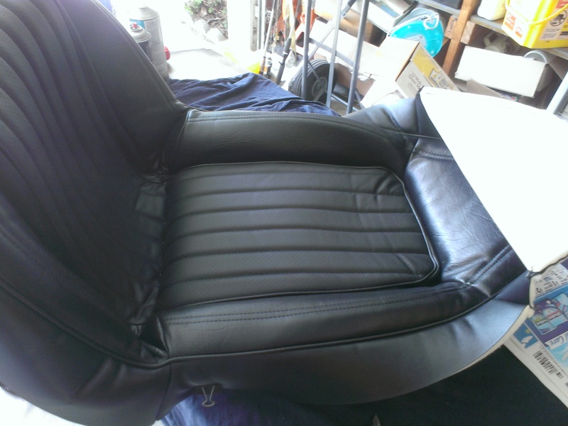

WOW !! Covering those seats looks like a project I can do without !!! I did the bench seats in the Elco & the Malibu, without too much agony !
This one is for the Elco, which is identical to the front bench in the Malibu...
The wrinkles came out somewhat with a hair dryer etc...
