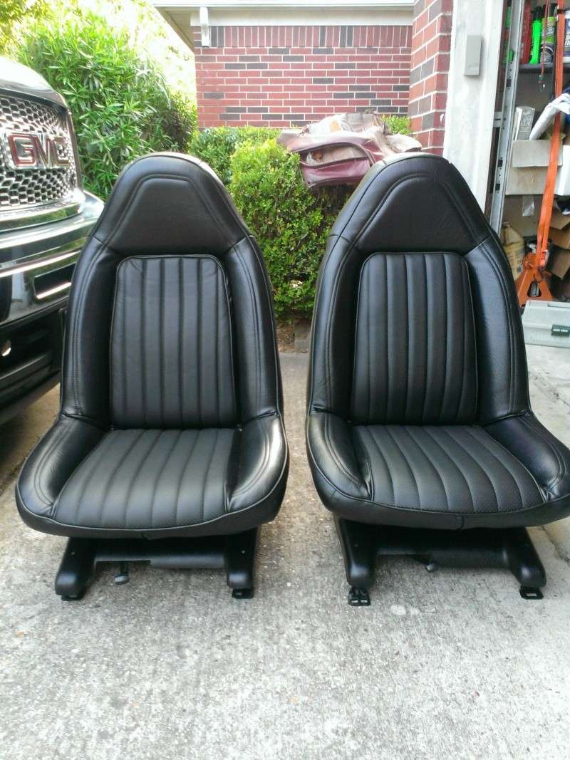

Post by g3chevy / Mr Pontiac Sat Jul 25, 2015 2:41 pm
I bought a set of upholstery for my 76 El Camino that was the 73 SS pattern in black. I had an upholstery shop install them and they looked like crap. So I took them apart and reinstalled them and they had a few wrinkles that eventually worked out but turned out pretty good. Here a pic.

Post by Limey SE Sat Jul 25, 2015 3:28 pm

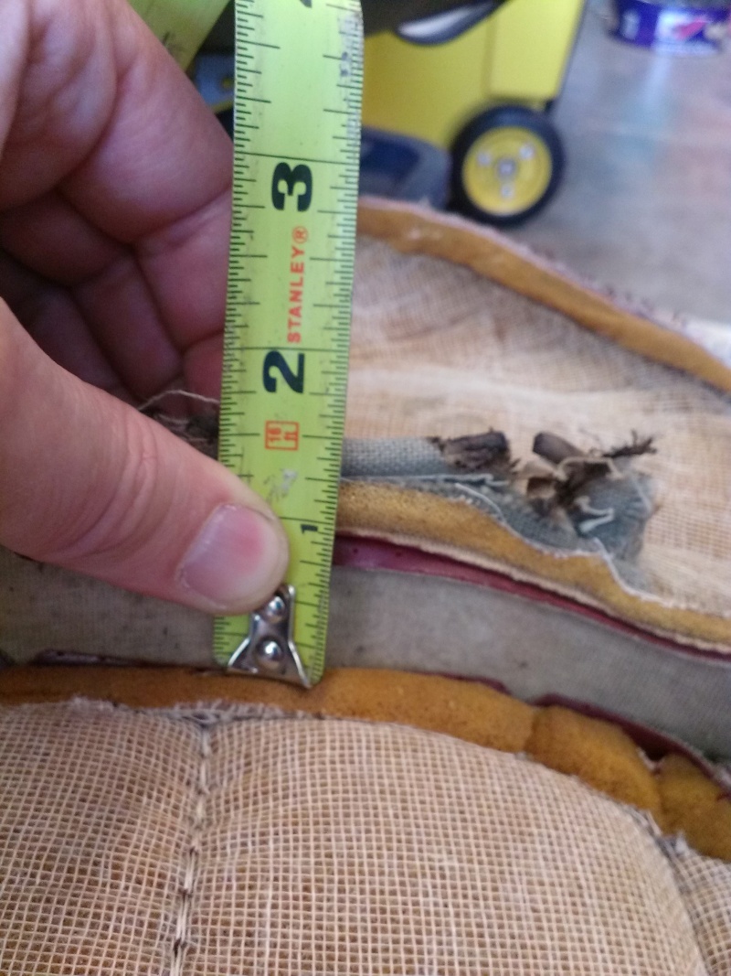

Post by g3chevy / Mr Pontiac Sat Jan 30, 2016 2:52 pm
The green colored foam is what I purchased from the hobby store to build up the new upper seat foams I purchased as a set from Tamraz on Ebay. I used spray adhesive to secure them in place. You can modify the shape of the foam with an 80 grit sanding disc if need be. Just be careful not to take off too much. I would practice on a spare piece of foam first just to get the hang of it. Attached are some pics to show the measurements of the original seat upholstery depth and the new ones, hence the reason you need additional foam.
Original Upholstery Measurement From Listing to Top Edge - 1.5 Inches:
Where to purchase seat covers Origin10
