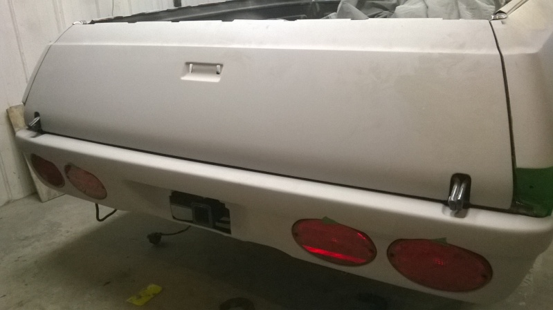

Rear bumper look!

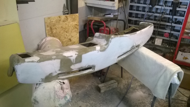

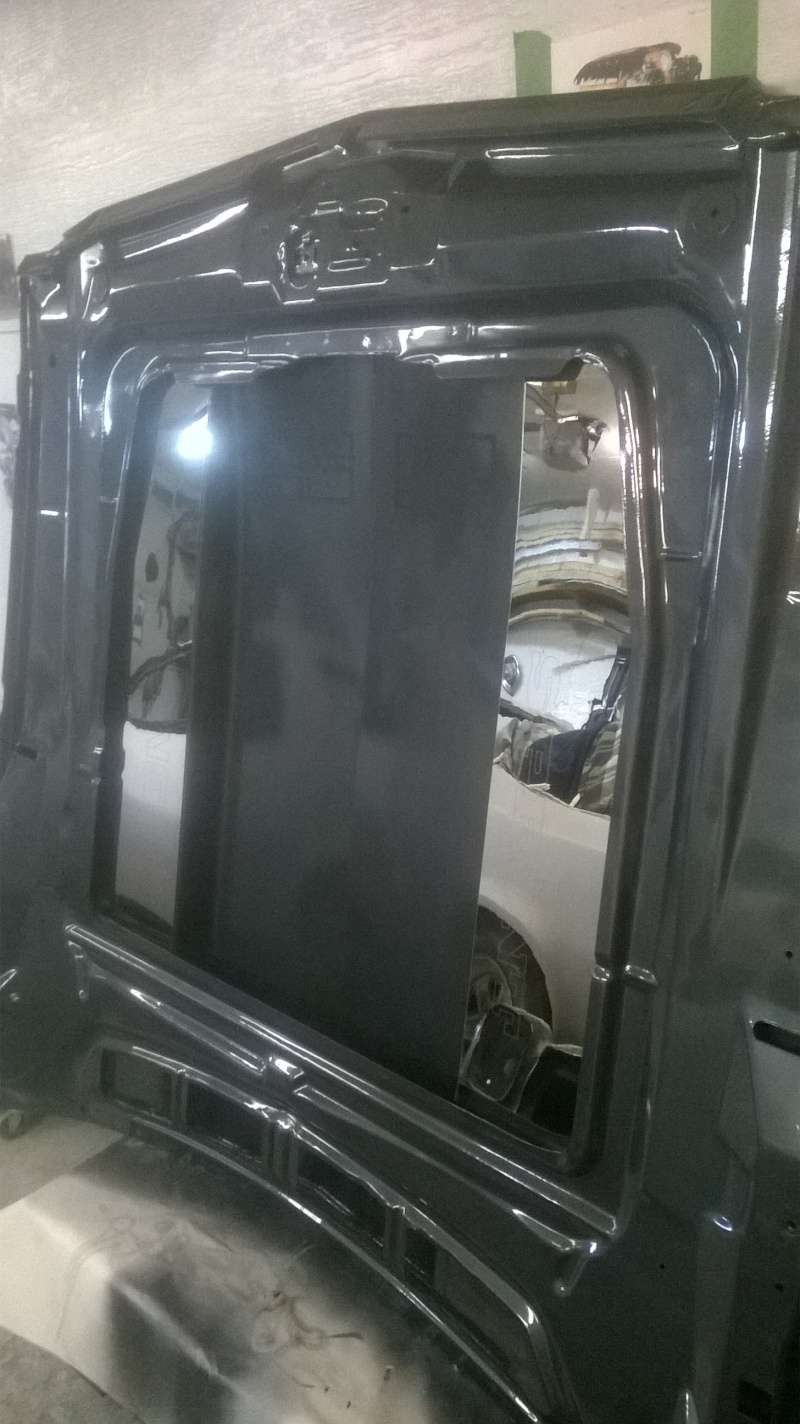

Tail gate molding modification;
Pad dash, bondo on hole and crack, 2 layer of fiberglass before black leather upholstery.
[/url
Work on the bed molding. I want it satin black.
The Laguna nose was not verry easy to fit!

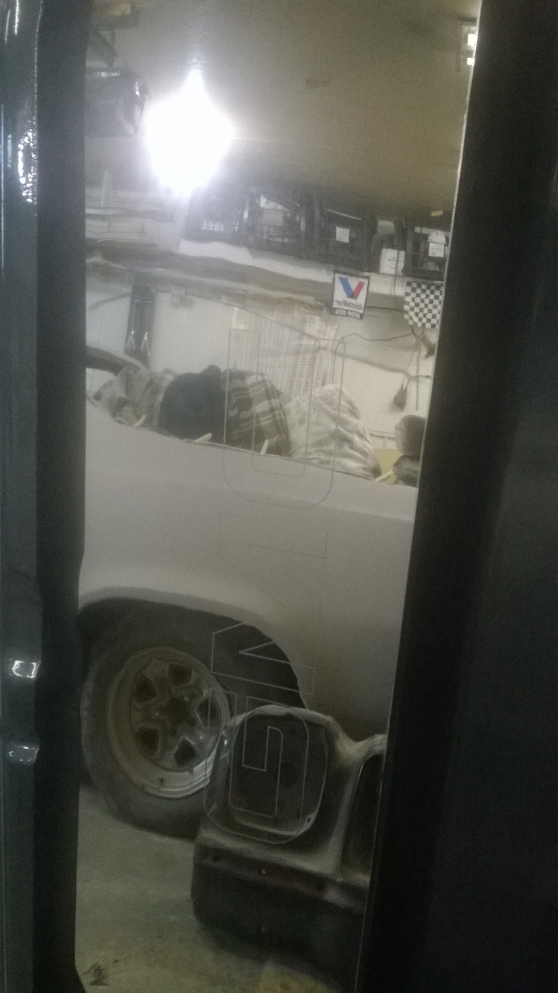

Re: 75 Gmc Sprint Sp from Quebec
I think i will cancel the Laguna nose!

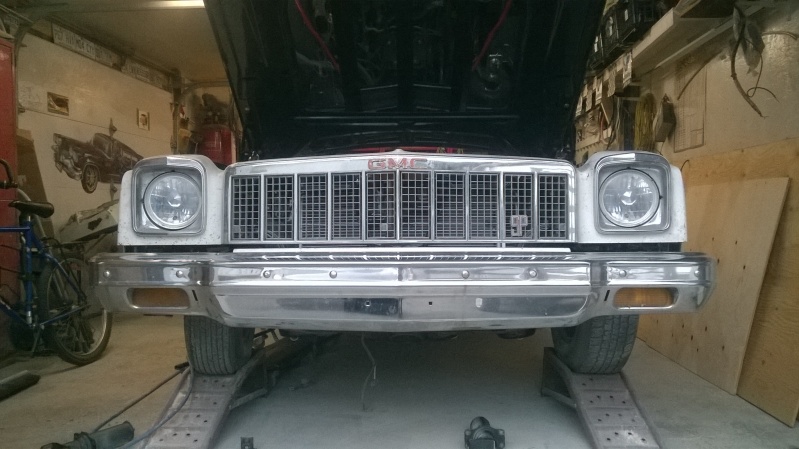

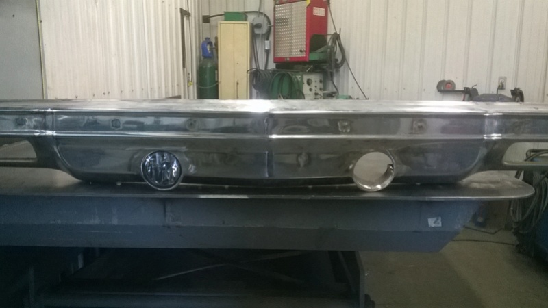

Some news!

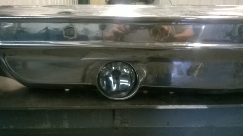

Recessed bumper;
Some modification of the front bumper;
Smoke fog lights;
Smoke parking light;
I will install 7" smoke headlight on the car and paint the bumper the same color of the car.

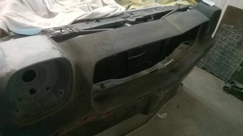

I cut all the inside of the front grill to try to make something custom;
I had some wiring problem to start the engine, i'm working on...
Recessed bumper;
Smoke fog lights;
