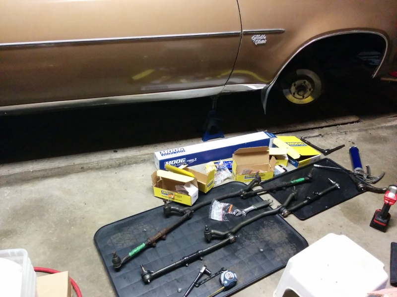

The parts list provided above fits on a 76 Malibu. I got it for 285$ CAD at summitracing and delivered within 3 days by Fedex. That is almost 200$ of savings!
I am looking for a tip to adjust the sleeves (toe-in). I tried with the tape but I don't get enough precision with it.
I think I could:
1. Put the old parts back
2. Put the tires back and remove the jack stands
3. Remove the old parts
4. Put the new parts by adjusting the sleeves until it goes in the holes (the tires won't move because they touch the ground)
Do you think 50 miles can be done with this setup before going to the alignment shop?
Otherwise I'll have to rent a trailer.
Here are the parts ready to be installed:

You will be fine driving it 50 miles once you get the new set-up in, Using a tape measure you won't get it bang on but for 50 miles you will be good to go. You may want to count the threads on the original tie rods and see how close you got it with your tape measure just a thought.
Parts look great and the $200 in savings is awesome.

I think you'll be fine for 50 miles. You can also assemble one side (tie rod/sleeve/tie rod) and lay it on the ground next to the your original set up. Then adjust the new to match the length of the old. It will be close enough.

Adjust the toe-in as best you can with the tape, but make sure to have actual toe-in and not toe-out. Drive it around the block after adjusting it. Tap the gas and let it coast. If it decelerates on its own quicker than it should, you have too much toe-in. Bump it out a touch and repeat. When it coasts along pretty well on its own, you're good enough to drive to the alignment shop.

When I did mine took all the old parts off as a unit and built the new parts on the bench side by side. Got it close enough on the first try for the drive. Good luck!

X2. Thats what I was saying. Match up the length side by side.

After trying several techniques I ended up using the rope trick. I watched several youtube videos, starting by "front end alignment".
I used a mason rope stretched from back to front tire then measured the front tire at the rim.
I found that the car _must_ be on the ground because the suspension geometry is altered on jack stands.
Another important detail is to check the steering wheel is straight with a level as often as you can (ask me why I know that !!!).
Then you have proper alignment when you are fed up of the "sleeve adjustment / rim measurement / steering wheel check" drill
