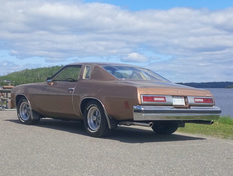

My car now has the exhaust out the back. Â The muffler shop guy talked me into running it that way. Â I don't really like it because you can really see a lot of the tail pipe from the side, and he put on massive truck style tips. Â Does anyone have nice pics of a rear exit that is more factory like? Â I am thinking of redoing the tail piple and going to either factory style or perhaps a behind the rear wheel exit.
Here's what I have now.
76 Malibu- G3GM Member
Re: Opinions on tailpipe exit
I agree. A tucked up tailpipe would be nicer. And either factory turndowns or cbrome tips would look good as well. Yours remind me of the monte ss tailpipes in the 80s. Car looks great!!!!
