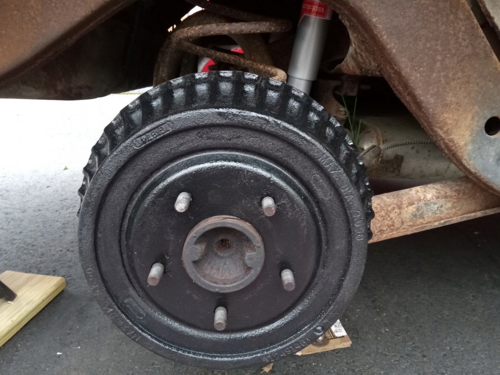

Look who's back in the game! After more stops and starts, I've replaced the rear passenger air shock with a new KYB shock, along with painting the brake drum using Rust-Oleum farm implement paint. Moving to the rear driver's side this week to do the same work. Next I'll move up front to replace the shocks there. This Winter will be reserved for getting the vehicle running again, hopefully before Spring arrives.

Replaced the rear driver's side air shock with the KYB shock and painted the brake drum. While I was painting the drum, I cleaned and painted driveshaft with the same Rust-Oleum implement paint. Whoever designed that front, upper nut location is not getting a Christmas card this year.. Moving to the front shocks next.

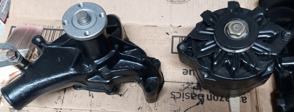

A few updates to report. I've purchased a Comp Cams he268 cam/lifter kit for the low compression 350, after finding a worn lobe on the cam I planned to use. Painted the intake, alternator and water pump. One more coat needed to make it right on the alternator. Also, finally installed the driver's side shock. Will update when more progress is made.
