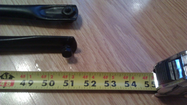

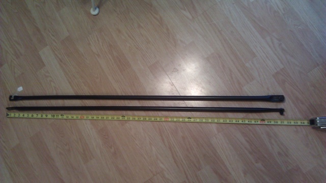

Monte Carlo and Grand Prix owners chime in Please, I need detailed pictures and Measurements of the Firewall to fender Support Bars if possible I need the Pictures and measurements OFF the car Please, Thanks Limey
Re: Monte Carlo and Grand Prix owners chime in Please
Not sure what you're up to there, Limey...but, here are the '73 Monte support rods I have. Measure 51 3/8" O.A.L.
By comparison, the Chevelle ones are 47 3/4" O.A.L.
![Monte Carlo and Grand Prix owners chime in Please 73mont10](https://i.servimg.com/u/f21/15/48/55/09/73mont10.jpg)
![Monte Carlo and Grand Prix owners chime in Please 73mont11](https://i.servimg.com/u/f21/15/48/55/09/73mont11.jpg)
Are they solid Bars or semi hollow ??
Definitely hollow inside...again, same as Chevelle.
10-4 thank you Steve
