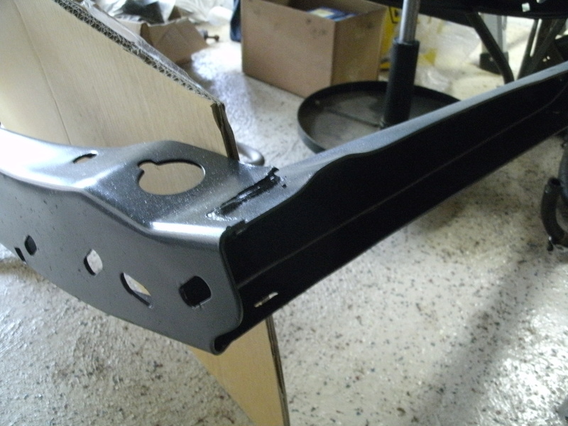

Lots involved, especially the rear. The quarter panels and rear frame are different, since the ‘73 didn’t have the 5 mph bumper. I think the only difference on the front is how the bumper shocks mount to the frame and the shocks themselves.

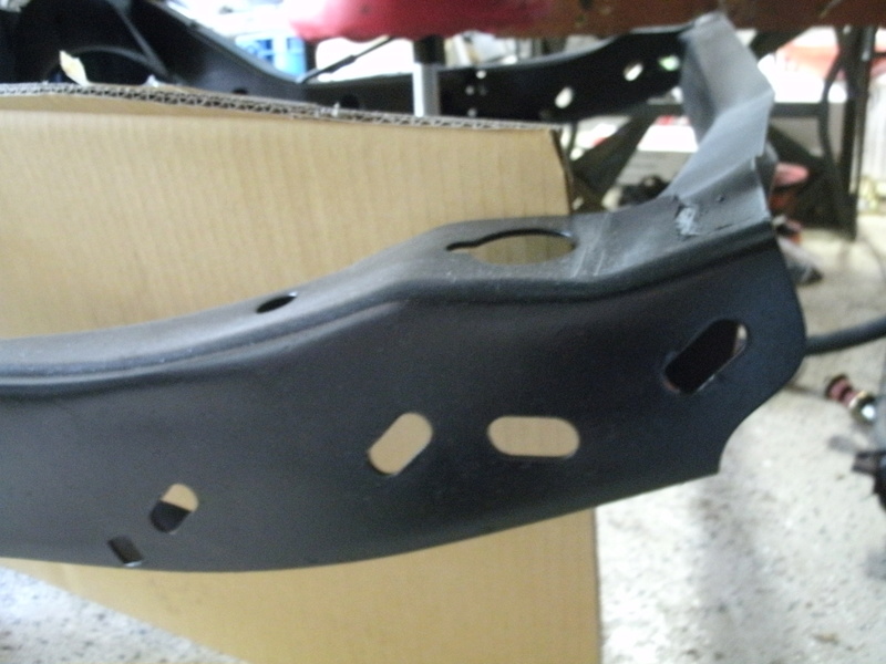

As for the rear, you just need to cut the tail panel off a 73 and graft it onto your 74. Its a good amount of work. Make sure you get the trunk latch as well since they are different. As for the 73 rear bumper, it doesnt have the 5 mph shocks and its mounting brackets bolt to the sides of the 73 only frame. It all can be done but the rear end work is quite substantial.
Heres some pics of the rear section of my 73 frame.
