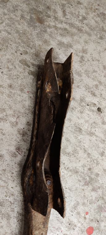

Post by Finn Monte Sun Nov 27, 2022 11:35 am
I removed the rear sway bar today. the control arms were rusted through from that attachment point. I ordered the Speedway Motors control arms and also the upper ones.
I took them without the bushing because I already have the energy suspension kit.

Monte Carlo -75 - Page 5 Empty Re: Monte Carlo -75
Post by g3chevy / Mr Pontiac Sun Nov 27, 2022 1:21 pm
Those control arms should work well. I buy a lot of stuff from Speedway since they have way better customer support than Summit or Jegs in my experience.
Post by zucchi Fri Dec 30, 2022 9:46 am
Finn Monte wrote:I ordered the Speedway Motors control arms…
I noticed these replacement control arms don't have provisions to accommodate the factory sway bar. I also see in your post a little further down that you refinished the front and rear sway bars, implying that you intend to reuse them.
Do you have a plan for adapting the rear sway bar onto the new control arms?
Have you considered upgrading the sway bars to slightly larger ones to reduce body roll? Perhaps 1/8" thicker in diameter?
Post by Finn Monte Fri Dec 30, 2022 10:08 am
I was thinking of welding the reinforcement to the place where the stabilizer is attached and then I will make the threads for the attachment. i think i use this original stabilizer.
these are still sailing somewhere in the Atlantic, because air freight from Speedway Motors would have cost more than $400.
Post by Finn Monte Fri Jan 06, 2023 6:14 am
however, I do it so that I put the pipes inside the stabilizer, that way I would get the bolts through the stabilizer.
Post by Limey SE Fri Jan 06, 2023 11:29 am
Finn Monte wrote:
If you can source a 9c1 code on tag ........1977 and Up Police taxi cab Impala Caprice or 1994 -1996 Impala in a salvage yard over there they will adapt perfectly and most are the Larger 1" diameter for the rear
Post by Finn Monte Sat Jan 07, 2023 4:54 am
those cars are more than rare here. it's almost impossible to find that.
there are regular Caprice station wagons and other similar GM brands, year 84-89.
Post by Limey SE Sat Jan 07, 2023 5:21 pm
Finn Monte wrote:
If they have the 9c1 axle code your good to go
Post by impalamonte Mon Jan 09, 2023 4:51 pm
Finn ,
 I have some information within my thread on the B-BODY spindle conversion.
 https://www.g3gm.com/t8709p25-update-1973-monte-carlo-body-off-frame-resto-now-with-ls
  Page 2.  And as you travel down the page.
  Keep in mind the conversion will draw the front tires inboard 1/4" geometrically if you were to use control arms from a 94-96 Caprice / Impala.
Post by Finn Monte Wed Jan 25, 2023 12:13 pm
Finn Monte wrote:I removed the rear sway bar today. the control arms were rusted through from that attachment point. I ordered the Speedway Motors control arms and also the upper ones.
https://www.speedwaymotors.com/1973-77-GM-A-Body-Rear-Control-Arms-with-Bushings,32715.html
today I received these control arms, it took 2 months to arrive by ship freight.
