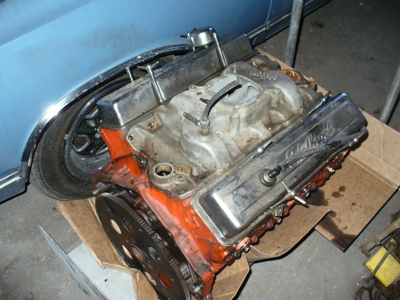

Old, tired 350 Chevy headed for a new life as a 383!

Does any body know much about Chevy block casting numbers. that old motor definitely ain't original to my car, and it AIN'T a chevelle engine, there are no letters on the block, only numbers. It appears to be a REALLY old motor.

Roadcaptain S3 wrote:Does any body know much about Chevy block casting numbers. that old motor definitely ain't original to my car, and it AIN'T a chevelle engine, there are no letters on the block, only numbers. It appears to be a REALLY old motor.
if you send me the number, ill take a look in my book when i get home from work either tonight or tomorrow and see what i can find for you.
Re: Motor and Tranny IN !!
Limey wrote:well post the numbers brother
I had the #s written down, now i can't find the paper it was on, i'll get 'em tomorrow and get them on here.
It was on like 7-8 digits long, and only numbers. The Chevelle reference book I've got says that all chevelles since 64 had a mixture of letters and numbers on the block.
Alrighty:
1GM in big letters, then below that
3970010- That's it, tried to get a pic, too much glare to make it out.
Located on the top-back end of the block above where the tranny bolts up/

Well if that ain't a common enough casting!? It's a 350, probably the factory one. This casting was used from 69-79 in trucks, Chevelles, Corvettes, Camaros, Novas, etc. It's also the same casting used for the 302 in 69 & the 70-72 Corvette motors. Some are 2 bolt main, some are 4 bolt main. Should be some date castings on the block to let you know for sure, but I bet it's the factory 350.
Maybe. The chevelle reference book I have shows every year having some sort of letter designation on the blocks. Could be horse hockey.
There are some other stamps on the other side, but too small and worn for me to make out-only a few digits visible.
This was a two bolt btw.
Also, the guy who is letting me use his shop said ther was some indicator on there that leads him to believe it's an older block-can't remember what it was, but some sort of mounting point that hasn't been in use since the mid/late sixties.
Naa you need the date code, Should be back on the bellhouseing flange near that long casting number, I had a 77 monte carlo all original had a 350 with that same casting number. The only way to figure out what it came in was the prefix code on the bad at the front of the engine on a pad sticking out in front of the pass side head. should be some letters and numbers.

Roadcaptain S3 wrote:Limey wrote:well post the numbers brother
Alrighty:
that is the exact same numbers I have on my 350 in the garage there has a stamp like a clock looking thing will the numbers kinda circled I can a pic later if you cant find that will tel you the year from that stamp its a little bit smaller than a half dollar in size
Where would I look for that half dollar size stamp?
I've been over it pretty good, and those are the only ones that I can see, other than the stuff on the other side of the block, on the lip above where the starter mounts.
Bobby let me go out there later tonight and snap a pic where it shuld be and what it looks like
very common block casting.... like Jim said, check for the numbers on the front in front of the passengers side head. Also theres the date code on the back.
