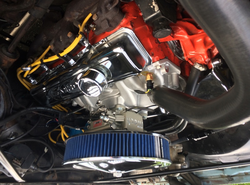

I've had my hot rod wagon home for about three weeks now and since the weather warmed up a bit I've been able to drive her around the block a few times. However, I have to get the damn brakes fixed as I've got a leak on the front passenger corner AND air in the lines (stopping is exciting). I also have a ticking coming from the same side of the engine so I'm trying to get it back to the students to get those two issues fixed. And I've got an oil leak at the dipstick that wasn't there before the engine work was done. Seems like the repairs never end!
The last thing that was done was fixing the transmission leak; apparently the "bullet" needed replacement or repair. No more leaks.
I am not sure what I'll have done in the coming months. I have a door that needs to be aligned so it will shut correctly and I'm going to get an estimate on having repairs made to the driver's side B and C pillars: there is rust damage where they meet the door sills and there are holes that should be patched.

I was able to fix all the remaining issues with the hot rod wagon: I replaced both front flexible brake lines, bled the brakes (three times
), quieted the clacking rocker arm, fixed the oil leak (turned out it was a distorted valve cover gasket) and got the door aligned! wooosh! I then took it to a local mechanic who correctly plumbed some vacuum lines and set the timing--runs smooth as glass now! I've been enjoying the local car show circuit and having a grand old time.
Next, save up some money for some body repair in a year or so.

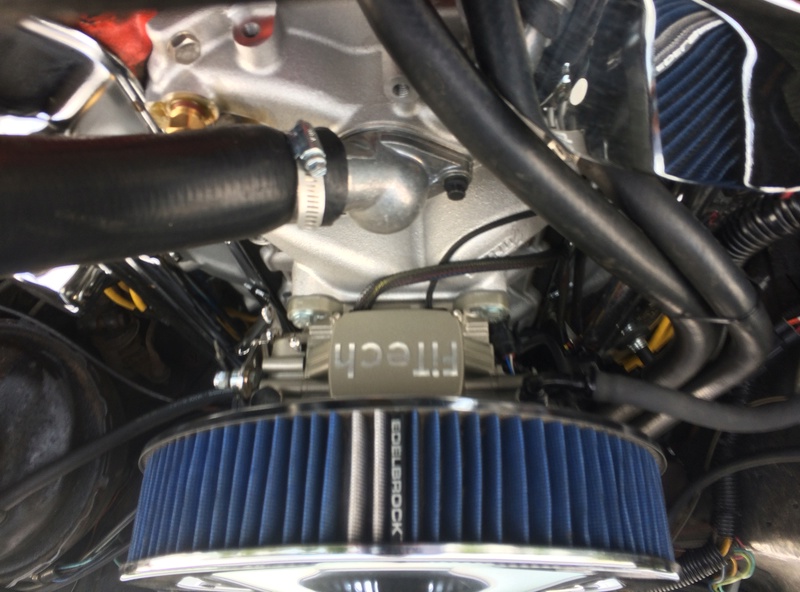

FiTech fuel injection & LED headlights
In May I (with a lot of help) installed FiTech's "Go Street EFI 400" fuel injection kit (including their "Fuel Command Center") along with a Summit Racing "Stage 1" dual-plane intake manifold.
Last week, I installed Summit's "Extreme Performance coated brake rotors" & Hawk HPS brake pads  and Oracle Lighting LED headlights.
With the help of professionals, the FI installation took 6 hours. The fuel injection settings took a while to get dialed in (I'll give details if wanted) but now the car is running very well. Â The first thing I noticed was that there is no more waiting for car to warm up and drive. Â Turn the key, start 'er up and off you go. No racing high idle or stalling when you put it in gear. Â I have noticed some performance gain (considering moderate performance level of engine and 4300 pound car) when mashing the pedal but it did not turn the car into a fire-breathing beast. Â Throttle response is much better and fuel economy is about the same, but I have to re-calculate this weekend to confirm. Â The cool part is the hand-held unit that allows you to customize many fuel delivery parameters. Â I tried tweaking several, made a mess of things, reverted to the baseline settings and left them there. Â You can also watch those parameters in real-time through the hand-held device. Â Fit and finish on the parts is very good and instructions that came with kit were good also. Â Customer support from FiTech is, um, moderate.
The rotors and pads are an improvement over the 30-year old units that were on the car. Â I followed the break-in directions for the pads and all has been well since--pedal feel is better and the seat of my pants tells me the wagon slows down quicker. Â Still not as good as those in my HHR, but there is 32 years of braking system progress between the two vehicles.
The headlights are a tremendous enhancement. Â I can see so much better at night compared to the previous halogen sealed-beam units--field and depth of vision is increased and reflective road signs really pop out.

For anyone thinking of replacing their carburetor with a TBI kit, here is the review I wrote about my experience with a FiTech system.
This combo was installed in May 2017 on a 1975 Chevelle station wagon with a 350 SBC making 150-200HP and has been driven about 2000 miles. First, it is a tremendous improvement over the Quadrajet that it replaced. Keep in mind that I learned the Qjet never functioned correctly and had only been running on two barrels for the several years it was in use. So, I can't compare the FiTech unit to a fully-functioning Qjet.
THE GOOD: Packaging and presentation of parts is very good. Throttle body is nicely machined and looks pretty sitting on the engine. Fuel Command Center has gauges to monitor pressure of fuel flowing in and out. Hand-held controller has more adjustments than I know what to do with so I found it best to leave at stock tune for 350 V8. With the help of a licensed mechanic the installation took about 6 hours. That also included removal and replacement of intake manifold and a few other small projects done at the same time. Throttle body installation was easy (with help) but locating the Command Center in my engine bay was more difficult. I would have preferred a smaller unit for more flexibility in mounting locations and in hindsight I'd probably spring for the unit that places the fuel pump in the tank. No issues routing wiring or installing O2 sensor in exhaust pipe. When first started I noticed two things: 1. the accellerator pedal was very stiff--I had to later buy an adapter to relocate the end of the throttle cable to another hole in the throttle body butterfly linkage. 2. a new and impressive sucking sound coming from the intake! Good things must be coming!
THE BAD: After a week of use I noticed an irritating whine coming from the Fuel Command Center. When set at the PWM % as indicated in the instructions the whine was present, when I set PWM higher it immediately went away. 2-3 calls to FiTech support did not solve the problem. Two months later I gave up and returned the FCC for warranty service which took two weeks. When I re-connected the FCC the whine was gone but fuel was pouring out of the vent line. It took 2-3 more calls to FiTech support to talk to a tech who knew what the problem was. I decreased the FCC float height as directed and that solved the problem. No whine and the system worked well for two months until winter came.
THE UGLY: 1. Better tech support from manufacturer is needed. I would have saved time and money if I was first instructed to adjust FCC float height. Instructions were not completely clear on float adjustments. 2. to adjust float height you have to remove the 100PSI gauge, adjust float screw, re-attach gauge and test. In my situation, the best result of the carb-to-FI swap has undoubtedly been the ease of starting the car when cold. Gone are the three start/stall/retart cycles and 10 minutes on high RPM before the choke opens up. Temperatures in low 30s resulted in no stalling or hesitation and the cool thing was watching the system self-adjust using the in-car controller. After driving for a summer I can confirm that I didn't get more horsepower or a noticeable increase in fuel economy (it went down a bit on the highway to 16-18MPG). Ease of starting and increased response to accel pedal have been the real benefits.

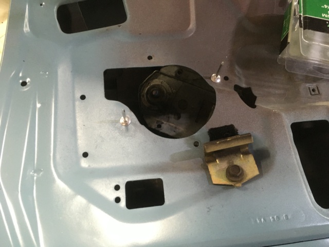

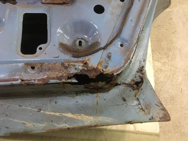

I finally got started on the door replacement project. The doors I was gifted a few years ago have languished too long and in December the first went in for paint. The internal parts have been swapped into the new door and I'm waiting on handles and lower door molding to arrive. Hinges were sandblasted and will get new paint also. The foam seal that goes around the bottom of the door is rough but still in one piece; that has been re-fitted with attachment pegs and is ready to install.
Next, I need to install the painted hinges, lower interior trim panel, moisture barrier, felt sound deadener and vapor barrier. my friend will help me install the door on the car, align the panel gaps and get it to close smoothly. Then, we adjust the window regulator and I can then install the upper interior trim panel.
The next door I will exchange is the driver's door; with luck I'll have that done by end of March.
