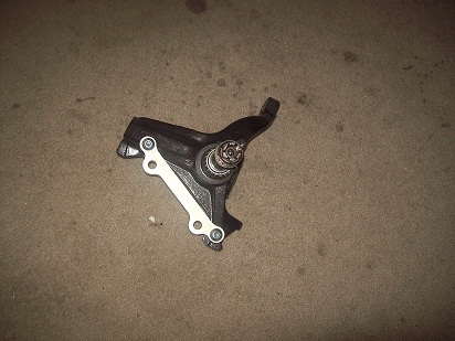

The braking system is going to use 2008 corvette z51 13.4" rotors and calipers on 86 camaro hubs that i cut rotor off on brake lathe at work and machined outer diameter so rotor was a slip fit . The rears are 2002 trans am rotors and calipers 12" .

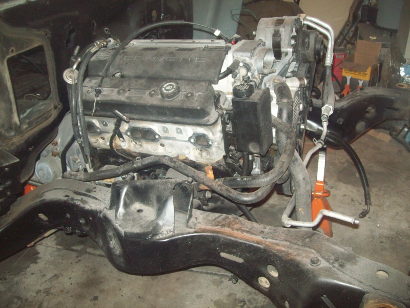

The engine is from a 93 corvette lt1 it was put in for mock up i modified the engine wiring harness for stand alone and modified a 95 caprice throttle cable to work . For fuel supply i am using a gas tank from a 96 impala ss just need to lengthen the straps and its a perfect fit .

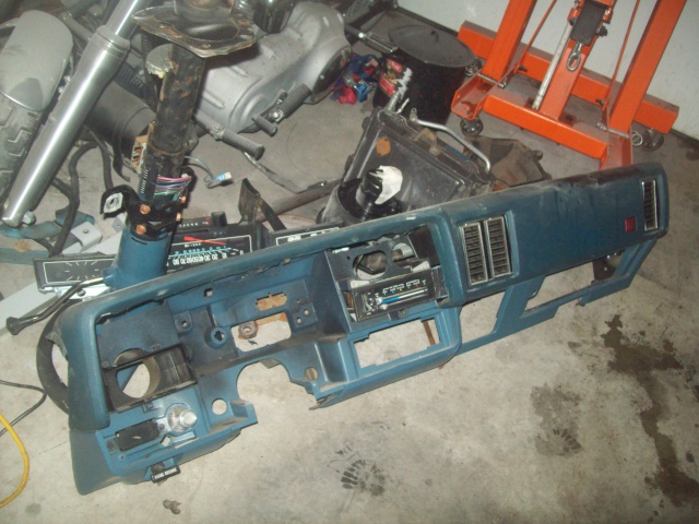

OPINION WANTED I AM THINKING OF FIBERGLASSING THE DASH PAD AND DOING CARBON FIBER OVERLAY ALONG WITH THE HOOD LUGUNA NOSE AND REAR SPOILER . WHAT DO YOU THINK ? Rear spoiler will be from a 2010 dodge challenger for visual . No offense but i am not into ricer cars i think the carbon fiber would set it apart . Paint will be either black or charcoal grey metallic

Thats right its an lt1 i got a good deal on engine and 700r4 trans . I will be putting a 6sp t56 when i find a good deal on one . The parts i listed i have been buying over the last year some with the money i got from the sale of the last car and the rest from not going out to eat and doing side work . I am a ASE certified GM tech so if i want some parts i get to spend hours doing sidework under someones car in their gravel driveway to get them my one car garage is full. NO SILVER SPOON HERE .

Started fiberglasing dash tonight
Never got any opinions on the carbon fiber dash laminate so i started without you . Fiberglassed the dash tonight its just rough finished but the nice part is cracks are gone . Just dashes 1100 $ i dont think so !
Please opinions wanted carbon fiber laminate dash or ?
Pics tommorrow.
Pics tommorrow.

No problem first on list for dash badtemper44but i have not seen car yet purchased through a freind . Just food for thought i am thinking of making a mold of the dash i just did to duplicate them . Not a dash cover but a dash .
I have a one peice dash the pad is not removable . But i am thinking a dash out of fiberglass is pretty simple if your not doing a resto and you could apply thin foam and vinyl or whatever . The 2 peice would be real easy i think .
It will be a lot of work and just considering it at this point but these cars need a choice other than spending a ridiculous amount of money on a restored dash .
Would there be an interest in something like that ?

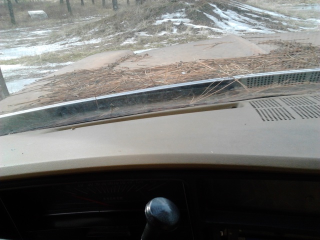

Well i went and looked at the 73 . For 50$ i bought it . Still has the dual exhaust trans crossmember glass is nice interior is suprisingly in great shape and the dash is in amazing shape it has no cracks from heater vents but a small crack where speaker goes . Fenders doors and front end good .
The quarters are rusted bad .
I will get pics up when i get it home and post parts i dont want on the classified section here .

Here is some pics of my 50$ dollar 73 chevelle . This thing was out in the woods . It came with title and keys . All he wanted was engine and trans When he said 50$ i couldnt get the money out of pocket fast enough . I found the car by asking a guy at work if he has seen any chevelles sitting around he says yeah my neighbor has on sitting in his field . [img]
