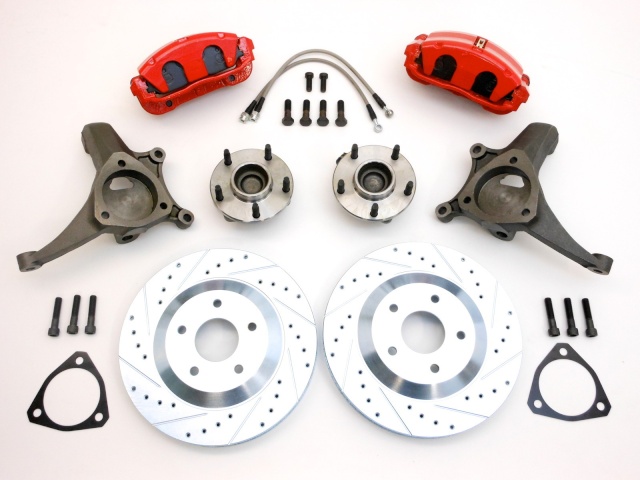

The one thing to watch for with the caprice spindle/brake set up is if you use 1LE parts (police car) the bolt pattern will change from 4.75 to 5 inch. The caprice rear end as well as the trailing arms and rear sway bar are also a bolt in.

They are selling a nice front kit on FeeBay for $649.00....
http://cgi.ebay.com/ws/eBayISAPI.dll?ViewItem&vxp=mtr&item=230937881687
![Here we go laguna clone pro touring build begining phase - Page 3 Front10](https://i.servimg.com/u/f74/15/99/31/04/front10.jpg)
Saving up my pennies...
Only thing I need to ask the seller is whether these are made in the USA or cheap Chinese crap

That's a really slick setup. Thanks for posting it.
one note: you need 17" or larger diameter wheels....so no vintage slot mags.

I was reading the description and it says 13" rotor & "will fit most 17" & larger wheels". What size are your rims Bio?
Re: Here we go laguna clone pro touring build begining phase
15" in Western Hurricanes for now but saving up for Boss 338's When I make the switch to big brakes.

Was doing some checking on those guys few bad reports about improper fitment and hard to deal with poor service. So maybe google them and see what you find as well.
