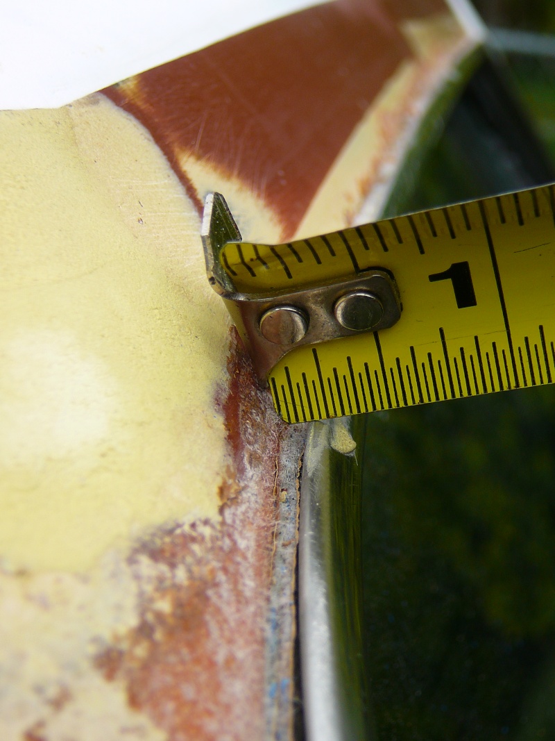

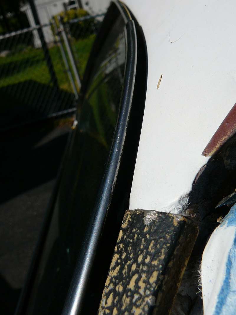

Bill- The stuff you sent will work great. I discovered (or remembered) that the seal tape is used under both the stainless drips & the roof rails. There will be areas where I'll have to use multiple layers of the seal tape but I monkeyed with it today and am very happy. I am incorporating a compressible closed cell foam with the roof rail install over the drips.
I never noticed but it's really funny how the stainless drip moldings fit up against the body. This is why I am doing one side at a time.
Thanks again!

Here's the side w/ the vinyl top mat'l still tucked in waiting for me....& the other side (w/ no seal strip- taken before I got your pkg).
