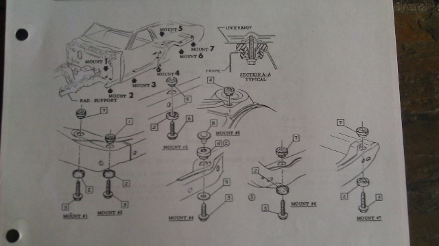

Body mount bushing location
Anyone have a part number listing or image if where the body mount bushings go on the frame? The bushings I have are factory GM, with the steel sleeves. And washer inserts. Apparently it looks as though some are different than others. I'll take some pics tonite after work. I checked the manuals and they don't give where each part number goes specifically on the frame.

Re: 76 laguna
This may be of some help. Out of the '77 GM Parts Catalog.

Re: 76 laguna
I had two different sizes in my kit from OPGI ('72 chevelle convertible). The smaller diameter ones went on the back of the frame for the trunk. The others went in all the other holes and the radiator support. The one without a bolt hole went on top of the frame above the rear wheel wells.

Re: 76 laguna
Thanks guys, looks like that's what I need, I called our GM parts guy that we deal with and it looks like with the info that he gave me and what everyone posted I'll be set!! The bushings were so deteriorated when I took the car apart that they just fell apart into nothing. Just wanted to be sure that they go in their perspective location.
