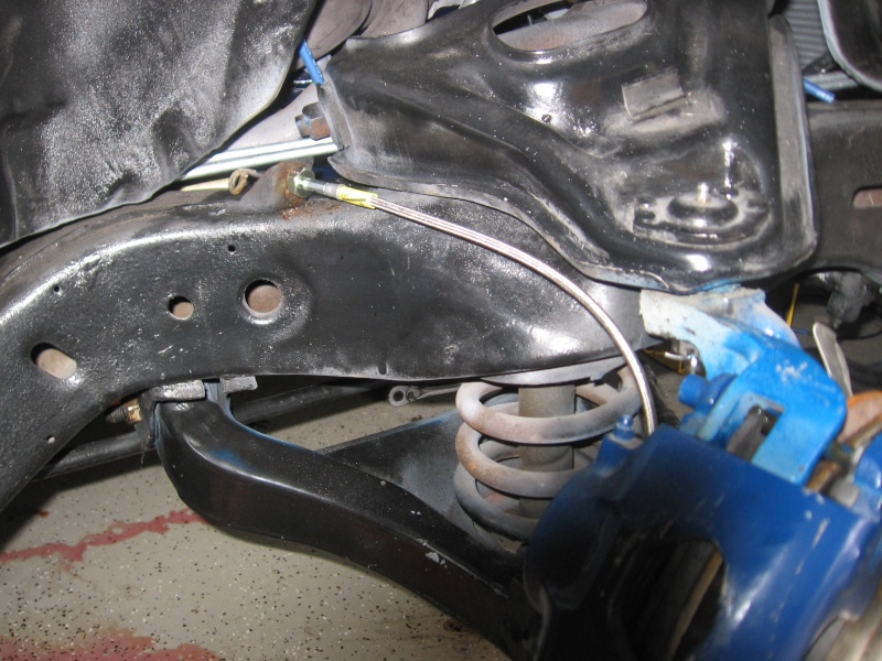

new Stainless Steel Brake Lines to calipers...not bolted into the hard lines just sitting there. still need the new hardlines
[img]
and now...
[img]
[img]
[img]
and now...
[img]
[img]

inlinetube's 7pc stainless steel brake line kit came today, almost done insalling them and ill put some pictures up. and yes i would recomend thier product.
-these are the hard lines mounted thoughtout the frame. going under the front (engine) crossmember to the passanger side front brake hose to the proportion valve and from the proportion valve to the drivers side front brake hose And from the proption valve to the brake hose mounted on the top of the rear end housing..then from the spit on that hose to each side of the rear brakes. then the two lines from the proprtion vale to he master cylender.
TIPS and TOOLS:
1/2" Wrench
1/2" socket and ratchet
flathead screwdriver or small Prybar
somthing to cut though the old metal lines
---If you have back problems dont even attempt this! im 17 and im skinny and barly have room to get the lines out. i reccomend anyone uses a lift just wish i could have used one

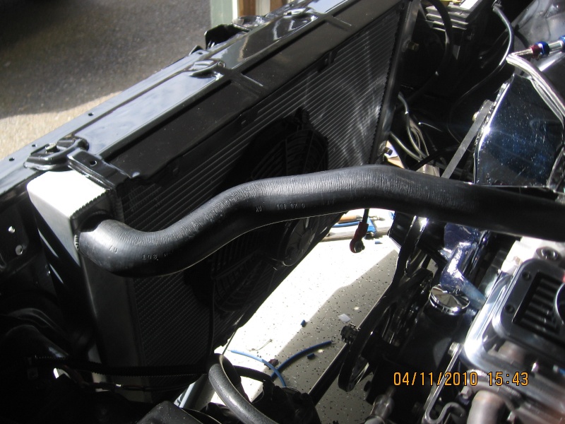

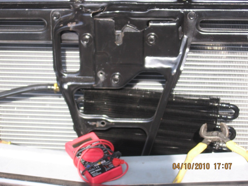

Spahl Electric fan and hayden transmission cooler Mounted.
[img]
[img]
[img]
[img]
[img]
[img]

Looking good, but do you think that fan is enough?
BlackChevelleSS- Management
Re: COREYS73CHEVELLE.
Looks really good man, clean. However, you might want to be careful with how you're mounting the cooler and fan. Every radiator manufacturer I've seen recommends that you do NOT use the plastic mounting ties. I just pulled this from some site, but they're all pretty much the same.
Try to avoid the plastic fan mounting ties made for this purpose (they look like a ribbed string with a disk at each end) as they will damage radiator fins and put all the weight and tension onto the core.
It might take a while for damage to happen, but with the price of aluminum radiators, you don't want to take that chance.
I'm also with Dan - I'm really curious to see if that single fan without a shroud is going to cool down the beast.
74Malibu383- Donating Member
74Malibu383 wrote:Looks really good man, clean. However, you might want to be careful with how you're mounting the cooler and fan. Every radiator manufacturer I've seen recommends that you do NOT use the plastic mounting ties. I just pulled this from some site, but they're all pretty much the same.
As for cooling for now it will be enough i got it from a friend who had it on a 427BBC that ran 9s, if i need another later i can still add one, and i know they say it will void the warrany on the radiator with ties but these work just as well and only cost $12 instead of $40 fo the normal mounts and theyll never know anyways.
Just remember, you get what you pay for...
Just a thought - You could make your own brackets out of some pre-cut strips of steel or aluminum from the local hardware store. A vise and a drill would be all you need to make your own. It would be stronger and you wouldn't have to worry about ruining the radiator.
these are just temporary until i can get the mounts made for them, i was carefull installing them and doubled up the pads.
