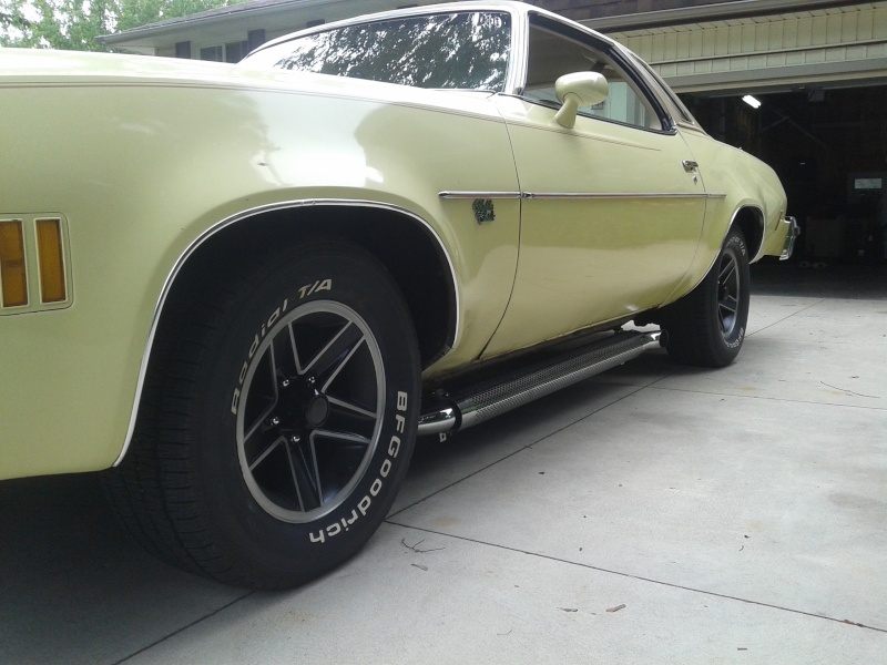

Post by Dinomyte Sat Aug 01, 2015 11:42 am
All done. . .
Headers, Side-pipes  - Page 3 20150716
I'll snap some pics from the top side at the Sunday night cruise, put about 150 miles on her since I got it back. . .  sounds really nice, turns more heads now than it did last Saturday with a completely open exhaust.
Headers, Side-pipes  - Page 3 Empty Re: Headers, Side-pipes
Post by dynchel Sat Aug 01, 2015 11:59 am
That looks more efficient than mine that go to the rear, do a 180° turn, then another 180° turn to go straight back.  At least they are all 1 1/2" mandrel bent pipe.
Post by Dinomyte Sat Aug 01, 2015 12:49 pm
dynchel wrote:That looks more efficient than mine that go to the rear, do a 180° turn, then another 180° turn to go straight back.  At least they are all 1 1/2" mandrel bent pipe.
If I remember correctly this is all 3", from the collector to the side pipe exit, I'll snap a picture from inside the engine compartment too later on.
The headers have a 3" collector, 1 5/8" inlets and are chromed 304 stainless.  The side pipes, we cut the 2" reduction off so that it was 3" there too (maybe 2 1/2").  That was partly want partly necessity, as this was a very tight fit, you can't tell from the angle of the pic above.
I was talking to an engineer, and to an HVAC guy who both said the same thing.  So long as the flow is smooth, you're not going to loose anything noticable in flow.  You will loose heat at each bend but not flow.  The other thing they both mentioned was that even if you were restricted at some point so long as it flowed enough to deal with the maximum volume you were pumping through then it didn't matter. So John don't worry about going back and forth so long as it's smooth.
Pictures coming tomorrow.

SO here's what they look like
Headers, Side-pipes  - Page 3 20150810
This is going to be my new avatar. . .
Am I the only one who thinks these tires still look small?
They are 255/60/15's in front and 255/70/15's in back.

Post by chevellelaguna Sun Aug 02, 2015 5:33 pm
The side pipes look wicked!!
Street Cred : 16
Post by dynchel Sun Aug 02, 2015 6:23 pm
The pipes look sweet. I think if your car sat a little lower the tires would look fine.
Post by thatfnthing Mon Aug 03, 2015 5:50 am
That looks fantastic! What a huge difference in appearance a couple things can make. Are those Camaro wheels?
Post by Limey SE Mon Aug 03, 2015 1:46 pm
yea third gen camaro IIRC he said, And wow Them Pipes look really good I think if you went to a 255/60 out Back maybe better I am not sure
Post by dynchel Mon Aug 03, 2015 2:07 pm
The problem with wider tires is his oe rims are only 7" (I'm assuming) wide. Any wide tire may look silly.
Post by Dinomyte Mon Aug 03, 2015 4:39 pm
Yes they are Camaro z/28 rims from the mid '80s 15x7s so the 255/60s just fit, anything wider would need to have a bigger profile, or a wider rim. I don't know about lowering the car, I've already bottomed once but that was more me doing 45miles down a hill, bottoming at the bottom as the car squatted to compensate for the uphill. Smile It's also the first drive I've taken with the new anti sway bars on. Those make a big difference. 1 1/4" up front (from a second gen Trams Am) and 1" out back (from an '95 Impala SS) Corners much nicer, much more level, doesn't feel like a boat.
