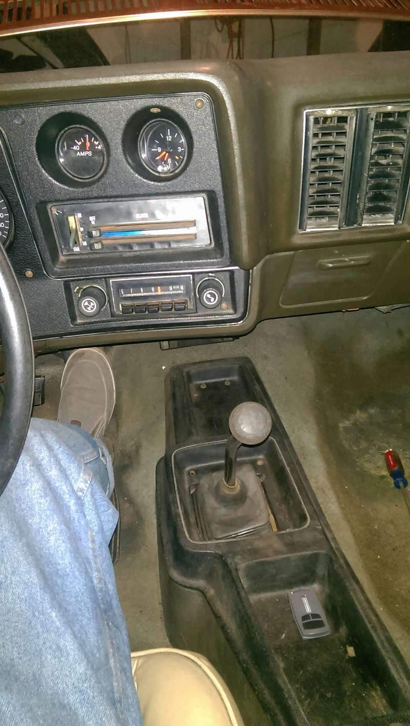

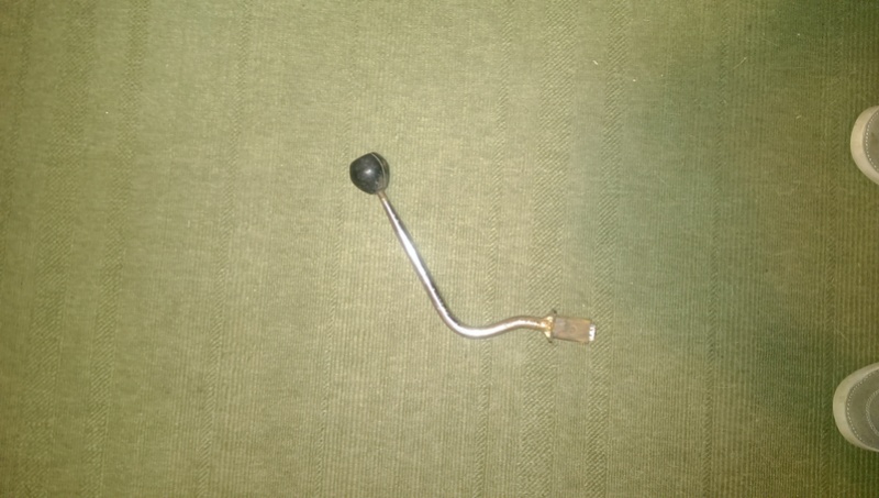

Update: while my search for an original correct 1973-1974 Chevelle ITM shifter stick continues, in the mean time I can finally get rid of that Pontiac stick that dented my console! I just picked up an ITM stick from a 1980 Chevrolet El Camino which, while not the correct original 1973-1974 Chevrolet Chevelle shape, is worlds better than that Pontiac stick and won't ever come close to contacting my console anymore. The Pontiac stick has those funky bends because the Pontiac console had the opening in the center of the console and the opening was longer, vs. mine which has a more-square opening, offset towards the driver and centered on the stick mechanism.
I'm reusing that old beat up knob for now because that's what I have. Gonna sell that Pontiac stick to a Pontiac specialist.

Post by Joe73 Mon Dec 12, 2016 11:19 pm
Nice. And looks way.better too.
