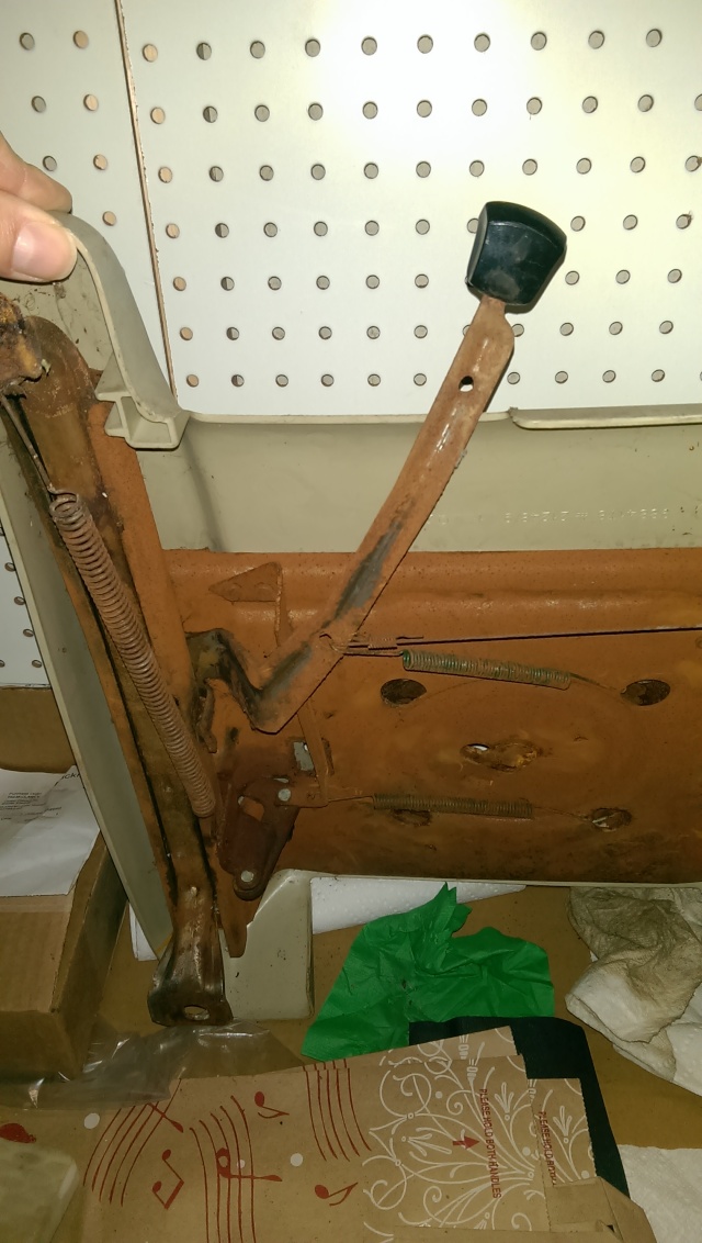

I'm getting ready to restore my 73 SS swivel bucket bases, including allthe tracks, mounting braces, levers, etc. and when I look at the parts from by car, it appears they were never painted from the factory, but some sort of galvanizing/phosphate/etc. don't know the correct term or finish. Definately not chrome, but no trace of old paint.
I'd like to see if I can get them redone factory. They'd probably need to be media blasted and then cleaned and re-phosphated-or-whatever the term is.
If it proves to be way too expensive, then I'll go the Eastwood paint "simulated phosphate" route.
Does anybody know the origin of the finish and what it's called and if it can be redone? My parts have a lot of surface rust but not damage. Factory plastic knobs are in good shape.

I've had a least a half dozen of these seats over the years and never noticed it ever being other than bare metal.

Seems to be the case. Maybe I should media blast, and then just sealer and clear?

I think media or dustless and then some flat clear. Only question would be getting any type of media or glass out of the swivel mechanism itself.

I got a good suggestion from another forum. soak the parts in rust remover, then either WD-40 them, or powdercoat them in a bare steel color. I might try soak, then flat clear.

Forget the rust remover. Run over to walmart and pick up a couple gallon jugs of Heinz white vinegar for like 3 bucks a gallon. Soak the parts in vinegar for a couple days. You will be amazed.
And save the used vinegar and reuse it.

I'm game! a little oil and some herbs and seasoning and I got a nice salad dressing when I'm done. Hell I'll give it a shot. I've read that all you need to do after the soak in vinegar, is rinse with water, is that what you do? Then dry the parts and flat clear?

Yes , just water to neutralize . Then I hit it withwax and grease remover just in case. Love that stuff.
