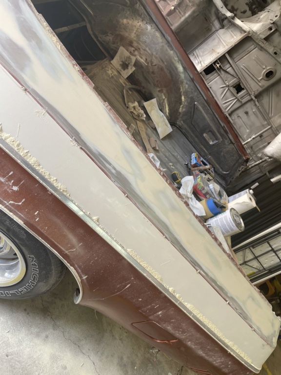

1975 El Camino - long term project  - Page 2 Empty Re: 1975 El Camino - long term project
Post by tgaetto Wed Oct 20, 2021 1:55 pm
And the sail panel. I wasn’t going to do all this but the seam filler was cracking so I figured it should get some attention while I was there. It is tough to stop. It keeps going and going! I had to draw the line. I removed all the old filler and replaced it. It was covering some welds which revealed the 1/4 had been replaced. 1975 El Camino - long term project  - Page 2 C3c87810
1975 El Camino - long term project  - Page 2 7fd77e10
1975 El Camino - long term project  - Page 2 40679d10

Post by tgaetto Wed Oct 20, 2021 1:59 pm
Now on to epoxy primer and then some 2k to help blend my amateur body work skills. Took some time to tape.. 1975 El Camino - long term project  - Page 2 4a1fe710
1975 El Camino - long term project  - Page 2 A5fb6b10
1975 El Camino - long term project  - Page 2 56bb3310
