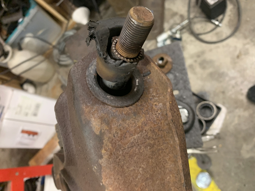

mine were pretty well absent of rubber but yes, the drill cut through it. I replaced my shafts so I was able to cut them to pull out each half. Don’t get too hung up on the process, just make sure you have a spacer between the center when you put them back together so you don’t bend the arm. 1975 El Camino - long term project  - Page 3 6805a210

S3TPI wrote:So you drill out the rubber to enable you to remove the cross shaft?  That's the part that looks tricky to me, removing the first bushing with the shaft in the way.  I have some I'll need to replace soon, and I would like to keep the original control arms.

S3TPI wrote:Interesting, I'll give that a try.  What size bit did you use?
I believe is was a 1/4" bit? You'll need to experiment with bit sizes to get it to work. When it does, it will start to work out the rubber bushing in one big piece. That saves a whole lot of time. Then I hit the outer shell with a chisel and it popped out pretty easy.

S3TPI wrote:Nice work, what method did you use to remove the control arm bushings?
I strongly encourage you to use the correct Kent-Moore tools to do that job; J-22269, J-24770-1, -2, -3 and follow the instructions in the service manual. It's way easier and doesn't risk damage to the control arm.

tgaetto wrote:mine were pretty well absent of rubber but yes, the drill cut through it. I replaced my shafts so I was able to cut them to pull out each half. Don’t get too hung up on the process, just make sure you have a spacer between the center when you put them back together so you don’t bend the arm. 1975 El Camino - long term project  - Page 3 6805a210
1975 El Camino - long term project  - Page 3 9ebb6b10
Thanks!
I will give it a shot. I would like to save the cross shaft if I can. The el Camino looks great!

Probably 5/16. I just grabbed one that looked like it would fit in the gap. I moved the drill around and used it like a reamer. First a couple straight through and then connected the holes by angling between them.
