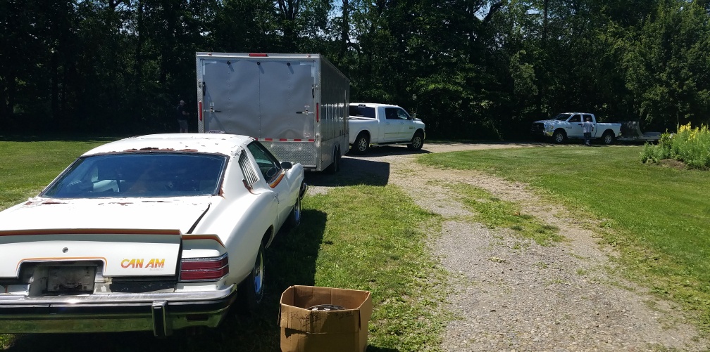

Finally uploaded some videos of the "Twins" that arrived Saturday afternoon. Trying to do my best to document the restoration of one of these cars. The other was determined to be a parts car thanks to the wisdom of Revin Kevin. He was a huge help Saturday unloading these cars as well as my oldest son that we volunteered to steer the first one coming off the transport. Kevin and I spent most of the afternoon going through both cars but we spent most of the time on the Sky Roof car since that's the one we decided to save. We really couldn't do a full inspection on the parts car since we were unable to get the hood open on Saturday. So we focused on the other and did all the normal stuff to try and start it after 20+ years. Pulled the plugs, squirted oil in the cylinders, disconnected the fuel supply line and stuck it in some fresh gas. Had to modify the battery cables to get the starter to crank, but with a little coaxing we got it to fire off. It was a bit noisy at first and then we realized the alternator was locked and the water pump bearings were toast. So knowing that, we ran it again for a few minutes and it ran pretty darn good for being in hibernation for so long. At that point we were pretty tired and decided to call it a day. Just gotta say thank you to Kevin for all his help and sharing his knowledge. So Sunday I spent a little more time with the parts car. Spent about an hour working the rusted hood latch loose so I could inspect the engine bay and engine. Needless to say, I think the engine is locked on this one since the previous owner took off the carb to have it rebuilt and didn't properly cover the intake manifold. There is literally moss growing inside the intake. Hopefully its a good core. We'll find out this fall when we pull it and tear it down. After documenting everything I could on that car, I spent the remainder of the day on the one I'm saving. Played more with the electrical stuff to see what works and what needs attention. I'm sure most of the electrical connections are corroded with all the moisture its been exposed to. The rest of the day was taking notes and video to get a game plan for the restoration. Below are some pics as well as videos Kevin and I took over the weekend. Hope you enjoy and look forward to comments and advice on this build.
Transport Company Arriving To Load Up Can Ams In Pennsylvania

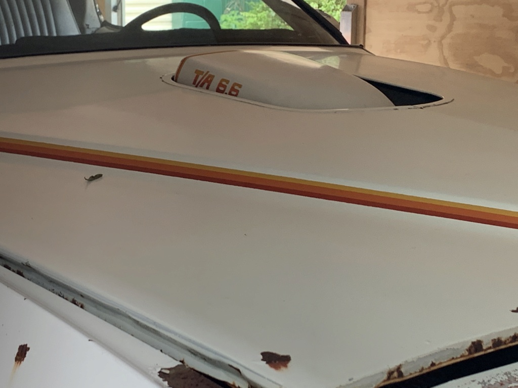

Looking at that air cleaner, Is the shaker actually open? I had read where those were sealed due to noise. What they call noise, I call music. Nothing beats the sound of the Q-jet war cry.

73ss wrote:Looking at that air cleaner, Is the shaker actually open? I had read where those were sealed due to noise. What they call noise, I call music. Nothing beats the sound of the Q-jet war cry.
Hey 73ss, the shaker is not open on this one. I've read that these Can Am shakers are actually from the 76 model year Trans Ams. So one article I read stated that this shaker is very similar to the 70-72 shakers that are functional and these can easily be upgraded to be functional. You'll never guess what I've added to my wish list for this car lol.

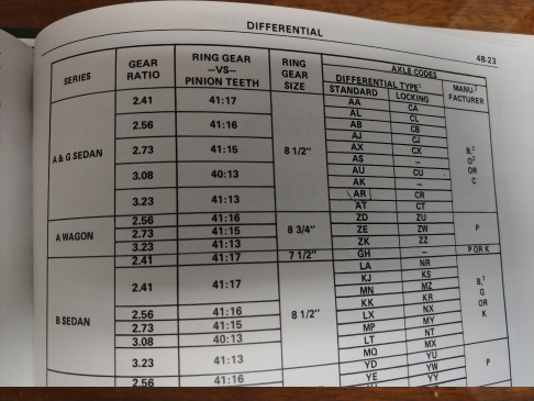

Was able to get a couple of miscellaneous things done today. Went to the DMV and got the title transferred into my name. Then I started pulling codes off of the engine block to figure out if it was the engine it was born with. Well after a lot of cleaning and wire brushing I was able to confirm its the original engine. The last 6 digits of the VIN were stamped on the front of the block exactly where Iggy mentioned it would be found as well as the engine code higher up on the block. This was "Y6" which indicates the 200 HP 4 Barrel motor with 8.0 to 1 compression as stated in the chart below courtesy of the link Iggy posted earlier. And I just received my factory Pontiac manuals today which is a 2 volume set and over 500 pages of pure reading bliss. Looked up the axle code in the book and it says the rear diff is an open gear with a 2.41 drive ratio. The Code "AA O" states in the manual that "AA" is 2.41 open and "O" is Oldsmobile as the manufacturer. So these are bolt in axles which is good. Not what I was expecting. The decal inside the trunk says it should have positraction. Now I have to see what the parts car has in it. Lots of stuff learned today for sure. Can Am fever continues...
WALLACERACING.COM
1977 400 200 HP Y6 A 8.0 112 6X 1-4 17057266 Firebird Block Casting # 500557
ENGINE VIN
ENGINE CODE
TRUNK DECAL
2 VOLUME GM SHOP MANUALs
REAR DIFFERENTIAL CODES
WALLACERACING.COM
ENGINE VIN
ENGINE CODE
TRUNK DECAL

I have borrowed pontiac service manuals in the past for a bolt in axle Olds rear overhaul and for a steering box overhaul. Very detailed info. Much more than the chevy service manual. I've wondered why they were so much more detailed over the chevy manuals.
My 73 came factory with a bolt in axle olds rear. I swapped it out years ago for a c clip type. Not knowing any better. I completely overhauled the olds rear 2 years ago. It looks to be a more robust rear over the "C" clip type. More robust welds, a deeper rear cover to hold more oil. Just a better built unit all around. It was a little tricky finding the correct axle seals for it but rock auto had them.
73ss- G3GM Enthusiast
Re: 1977 Pontiac Can Am Build
73ss wrote:I have borrowed pontiac service manuals in the past for a bolt in axle Olds rear overhaul and for a steering box overhaul. Very detailed info. Much more than the chevy service manual. I've wondered why they were so much more detailed over the chevy manuals.
Yeah, these Pontiac manuals have tons of detailed information in them. Almost twice as many pages at the Chevrolet manuals I have. I read a couple articles that stated these Olds rear ends are as tough as the 12 bolt rear ends. Not sure if that's true but I've sold a couple of these units to guys that race for a hobby. They seem to like them.
I don't think it would be as strong as a 12 bolt as it takes the same 8.5 carrier as the C clip type. At least mine did. I swapped the posi carrier from my C clip rear over to the olds axle. The axels are different, slightly larger in diameter from the spline out and no spot for a C clip.
The bad news with your rear if it is a 2.41 posi, It's virtually useless for a performance gear. I believe 2.56 was the cut off point. The carrier is slightly larger in diameter to accommodate the extra teeth of the 2.41/2.56 gears. In other words a 3.73 or other performance gear will not fit the 2.41 carrier.
Good info. I'll keep this in mind when I rebuild the rear end somewhere down the road. So I'm guessing I'll need a new carrier unit (posi of course) to get better gears?
