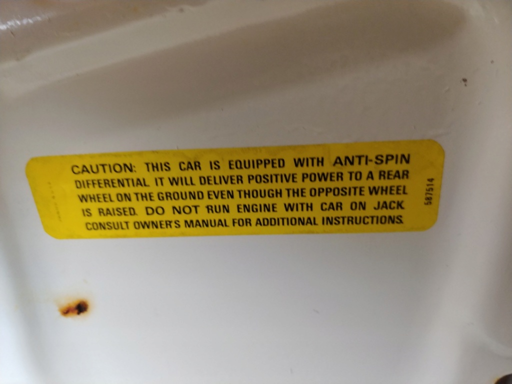

Kudos to you in picking these up and attempting to save one of them. I too own a Can Am and it's been in my family for 31 years. Bill Ostovich, myself, Rick Lightfoot, and a few others are excellent sources of info on these cars.
Was reading about the rear axle questions/concerns you have and if Pontiac equipped you should have a 3.23 8.5" 10-bolt limited-slip in it. These rears are plenty stout enough for most folks. I ran one in my '79 T/A weighing 3850 lbs. race ready on nitrous making 800-HP and the weakest link was the ring and pinion gear (which they don't make a softer "pro" gear for the 8.5" 10-bolt). Everything else lived.
If I were you I would send off to PHS for all the info on both cars. This is similar to the Marty report for Mustang owners. It will tell you how the car was equipped when it left the assembly line, when it was built, what dealer it went to, etc. Also, you may want to drop the fuel tank in each to see if you can locate the build sheet. That's where I found mine, taped to the top of the tank with masking tape. Other Can Am owners have found theirs in this location as well.

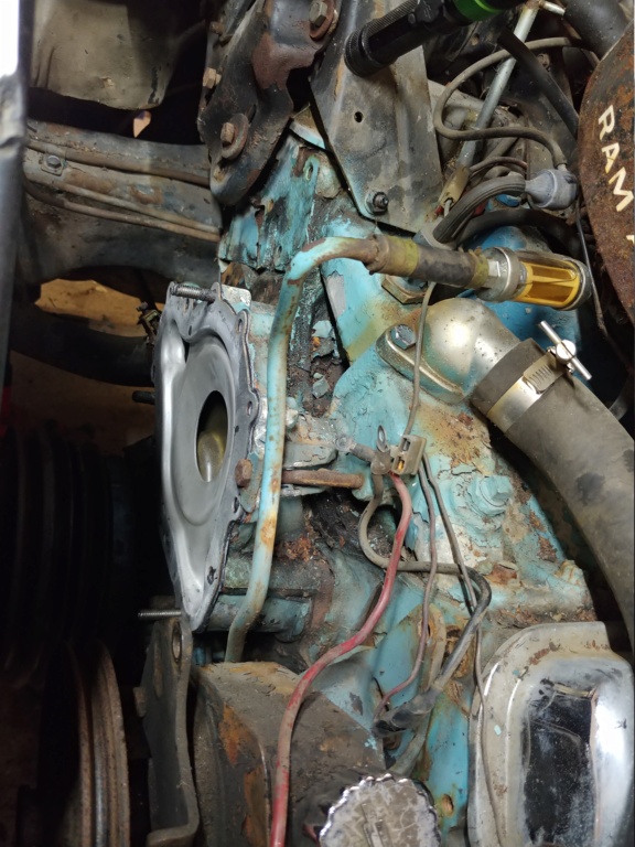

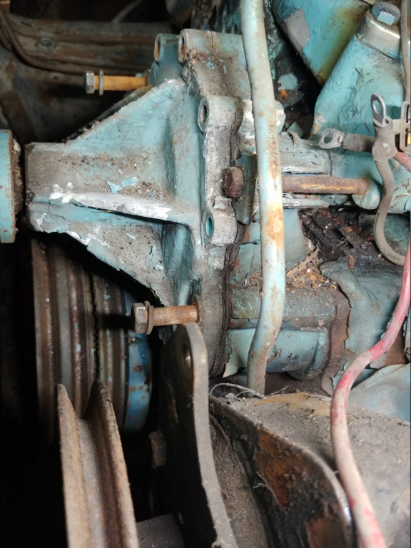

Engine Bay Items
Finally got a chance over the weekend to address the noisy water pump and locked up alternator. Also dropped the trans pan and changed the fluid and filter. The drivetrain seems to be rock solid. I'll know for sure after I replace most of the brake components and then take it for a real test drive.
