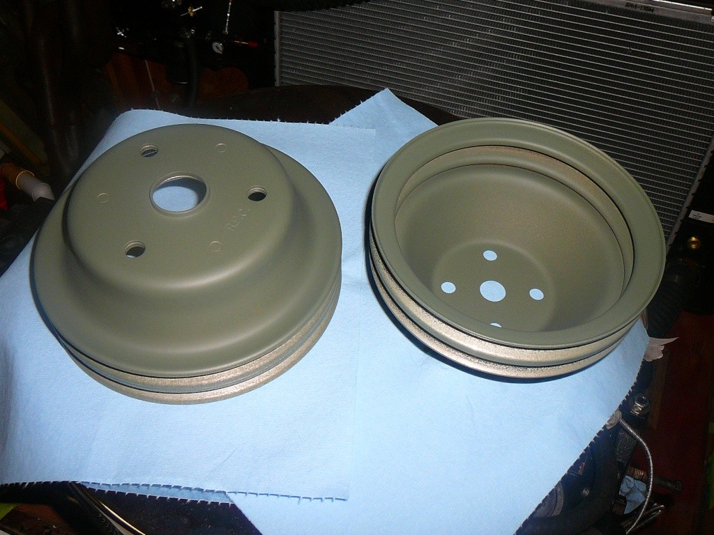

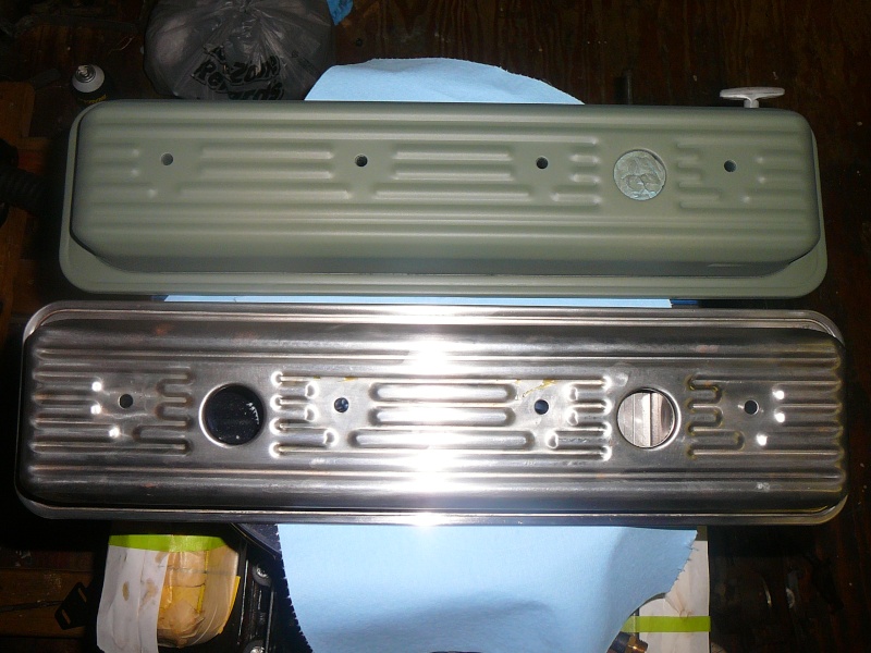

These are new pulleys which have dual slots for multiple belts.  They came chromed but have been scuffed and hit with Duplicolor self-etch primer. They'll make it easier to install the A/C, if that day ever comes.  Hand sanded my valve covers, which are also new and were already painted & on the motor.  They got messed up during break-in, so-back to bare metal & trying again with hopefully better longevity. These parts will be coated with POR 20 (heat resistant) & then get a topcoat of the final color, then clear coated with Duplicolor clear engine enamel.  Same thing for the balancer, less the accent color.  Leaving that the same as the block.

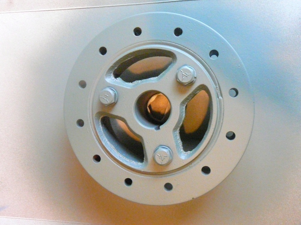

Made some progress also on the control arms & shafts, of course I forgot to take the bump stop off one before hand.  Oh well.  It's amazing that under all the paint, gunk, rust, etc..there are several ID numbers/date codes all over these things.  Pretty cool.  Still have one to go and to redo the one from "a long time ago".  These were brought down to bare metal and coated with POR15 after treating them with the POR product I used on the Chevelle's roof (last summer?)  LOL- it's all kind of blending in at this point time wise!  I think I found a topcoat that I like for these parts & the fire-wall.  We'll see, I'm going to try it over the upper arm that is done & see what it looks like compared to what I used on the lower arm that I did previously.  More to come soon hopefully.

Progress Paul. Every little bit counts! Before you know it it will all be back together!
1977 Chevelle Malibu Classic Progress Photo's aka Mali - Page 25 Empty Re: 1977 Chevelle Malibu Classic Progress Photo's aka Mali
Post by Joe73 Sat Oct 04, 2014 12:26 pm
Nice work!!! Gret feeling putting nice clean parts back in that you worked hard on.

Post by pila Sat Oct 04, 2014 2:31 pm
You are lookin' good Paul !! Very Happy
I use that self-etching primer quite a bit on aircraft parts, so I don't need to fire up a spray gun all the time.
Don't know if they will fit that engine, but I have the AC compressor brackets for the '77 around here if you need them for later etc.....

Thanks for the kind words Guys!  More progress today- painted the water-pump, engine pully's, balancer, Alt bracket, fan, harmonic-balancer.  Primed 1 control arm & the brake booster for final painting & I also POR-15'd the drive shaft.  LOL, busy day!  Found a nice flat black engine enamel- looks pretty stellar IMHO.  Paint for the arms will be different though, gotta spray w/ my compressor & gun. Might let the rest of the arms sit a while until I redo the engine.
Bill- IDK if those brackets will work either, but please save 'em for now.  I have part of the bracket assembly at least.  I gotta check- thanks A LOT for the offer!
