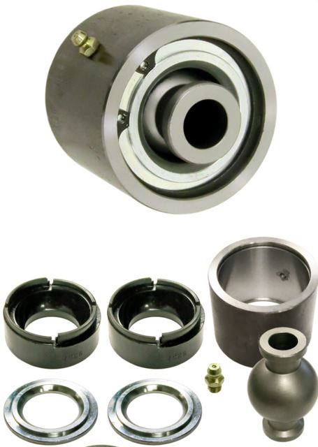

Getting closer... going with a "Johnny Joint" on the upper mount. Should allow for more movement and less binding of the rear end.
74Malibu383 Build - Page 9 Captur10
My friend brought the housing over this week and we put it up in the car. Took a TON of measurements, and tacked some pieces on. He's finishing up all the welding today (hopefully), but he sent me some photos. Getting pretty excited.
