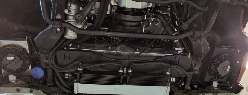

Been quite a while since I posted. Super long story short, I broke 3 pistons in the 572. Apparently the stock GM ZZ572 pistons weren't up for boost. So, I took it out and had it rebuilt with a bunch of really good parts. JE pistons, Oliver Rods, etc... Engine has been back in the car for a while now, but ever since I put the boosted 572 in, I've been fighting heat issues. It just gets too damn hot in AZ for this thing to cool itself down.
So, I was doing some research, and read that the 2017 Camaros have 3 radiators. I thought, why can't I do that. So, I did.... started off with 1 extra one (on the right), and it helped, but not enough. So, I plumbed in a second aux radiator (on the left, not painted yet) and I'm happy to say that cruising in town on a 105 degree day, with the A/C on high, it hit about 208, and on the highway, I'm at 195. Honestly, this upgrade was worth at least 20 degrees. It was pretty brutal anytime it was over 100 degrees outside.
208 might sound high, but all these new cars run around there, so I'm calling it a win. Still have a few more ideas on getting fresh air into the Procharger to knock a few more degrees off, but I believe I'm on the right track. Never thought I would see the day where there is literally no room to mount stuff on this damn car, but I think I'm there. OH.... and I put in a Z06 oil cooler as well. Thing is like 35" long. It's ridiculous.
So, now I have about 5 gallons of water/antifreeze, 3 radiators, 4 fans, and about 8 quarts of oil. In addition to the cooler, I had to run a remote oil filter setup to accommodate for a larger oil pan w/kick outs.

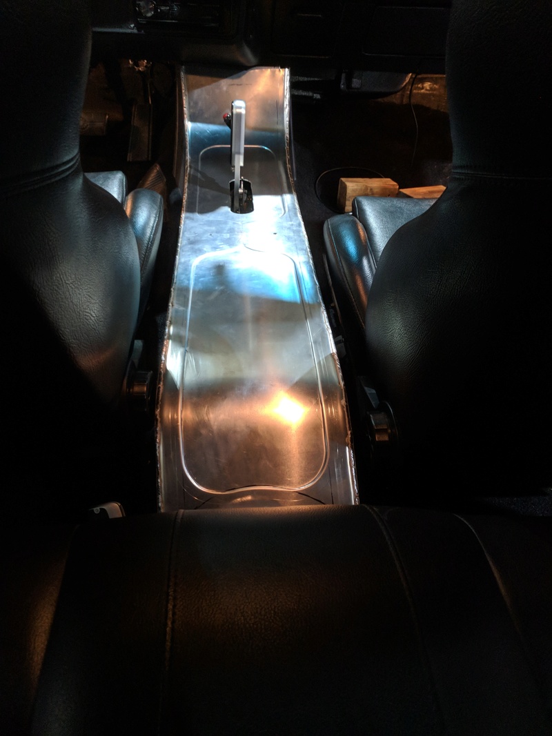

Center console... Finally. I've been on way too many Power Tours without cup holders!!!! This one is not going to be one of them. Pretty happy with the way it all came out! Powder coated with a leather wrapped armrest. Oh, and a little Holley Digital Dash for fun. Man, this thing is pretty damn cool! Just need to swap out some of the stainless hardware for some black ones, and call it a day.
74Malibu383- Donating Member
Re: 74Malibu383 Build
Looks good! The design and finish came out great.

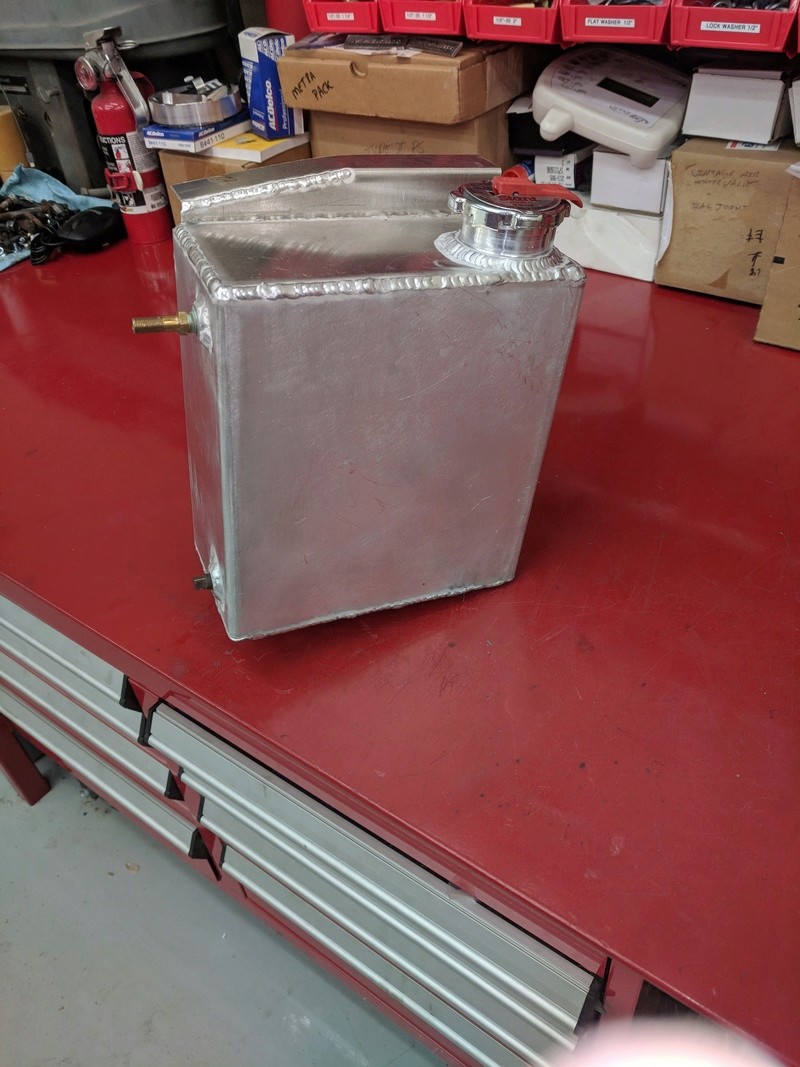

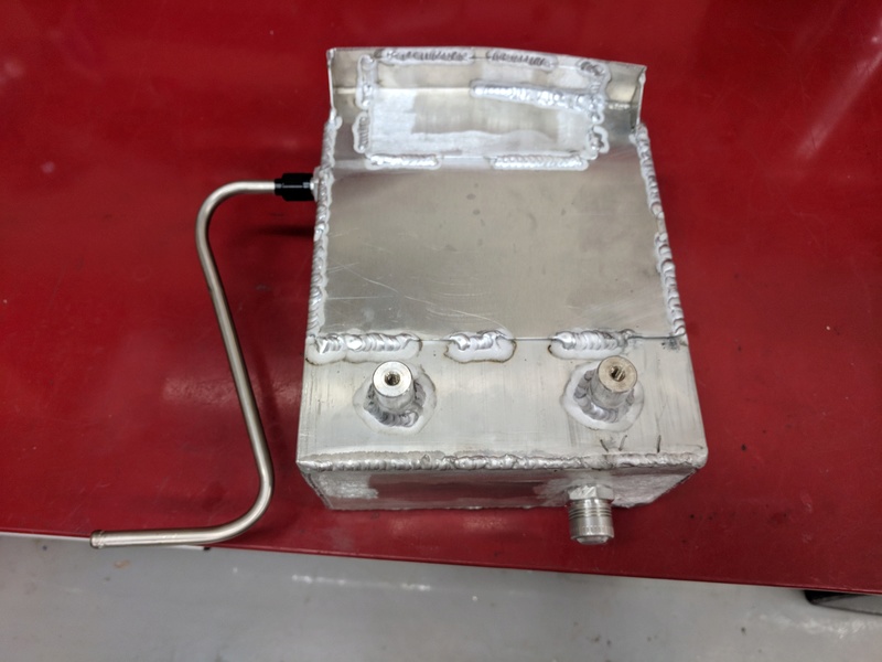

Thanks! Finished another little upgrade last night. Painted, and installed this custom coolant recovery/surge tank. Also bent up some stainless steel hard lines with tube nuts/-6AN fittings. It's got a clear sight tube so I can see the level of the coolant.
Took a lot longer to make than I was planning, but I couldn't find anything on the aftermarket that would fit where I needed it to fit, or have the capacity I was looking for. This thing holds just under a gallon.
Started with some aluminum square tubing, and milled down the front two corners for a rounded look. Put a piece of aluminum inside to act as a baffle and reduce any swirling.
Welded up the top, bottom, and all the npt/AN bungs. Bracket on the back with two rivnuts for the top mount, and two 1/4-20 bungs on the back to come through the firewall. Didn't want to drill through the firewall, but it's pretty heavy, and didn't trust just the top two mounting holes. Pressure tested it, found some leaks, fixed those, and mock/painted it up.
