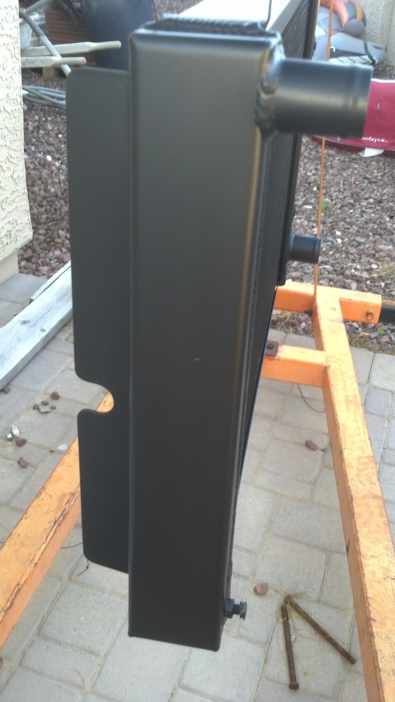

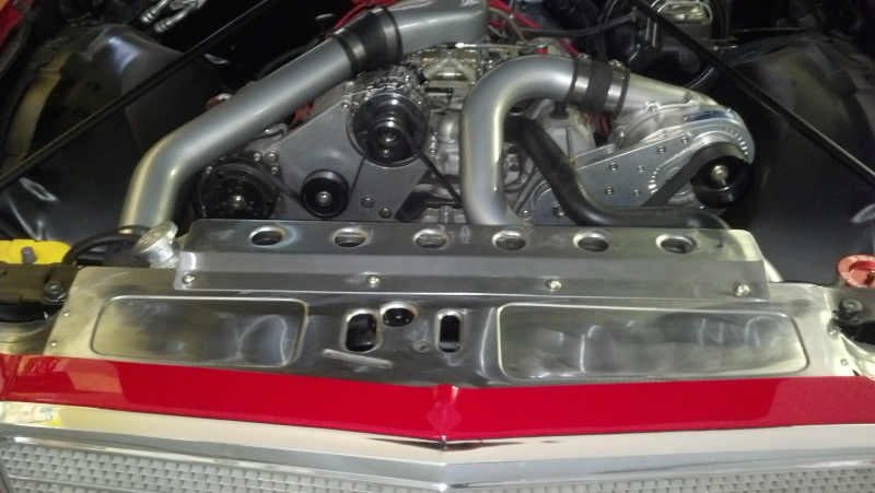

For some reason, the engine was running a little warm this summer in anything over 110 degrees. Imagine that...
The weird thing is the problem came in at highway speeds, not stopped like you would think. Anyway, I did a little experimenting with a couple different cardboard templates. Bottom line, they were worth 10 degrees. I was going to attempt the sheet metal work myself, but decided, it would probably take me more time and I would scrap more metal than it would be worth. So, I called up a good friend and this is the result. I still need to either paint or powder coat these pieces, but I'm super happy with how they came out.

Funny that cars do things like that...running perfect and then all of a sudden something changes. The sheet metal work looks really good.74Malibu383 wrote:For some reason, the engine was running a little warm this summer in anything over 110 degrees. Imagine that...

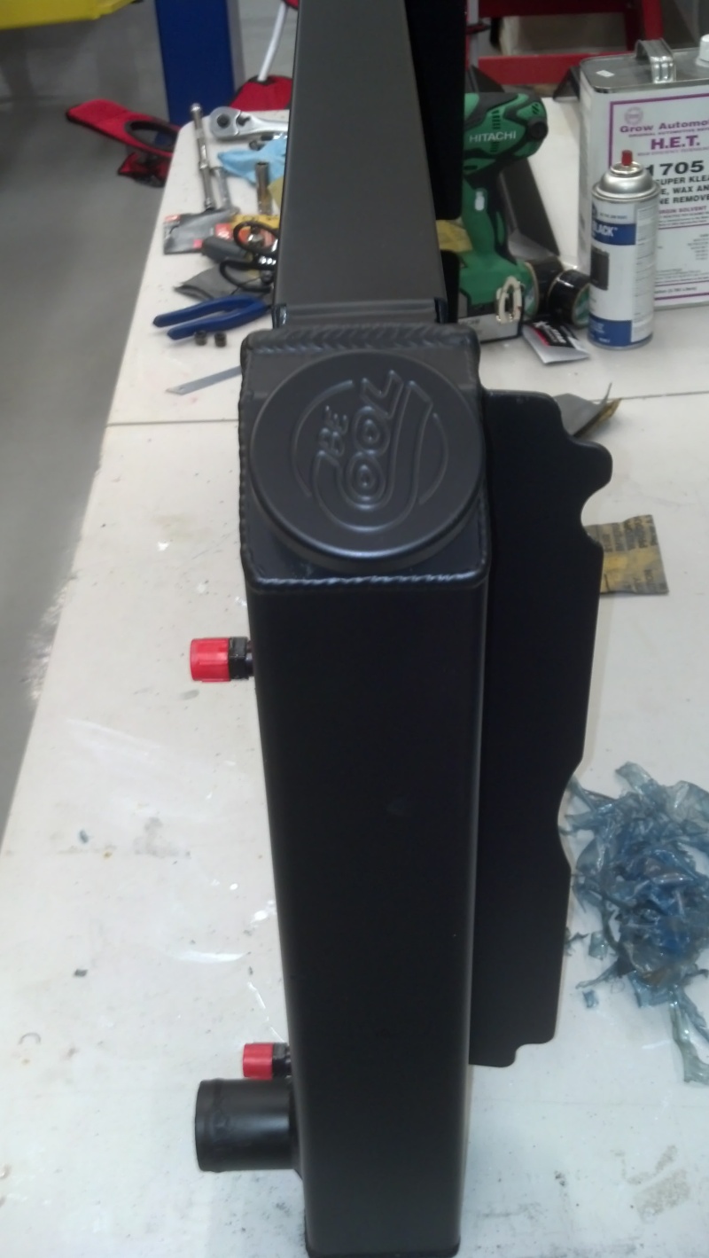

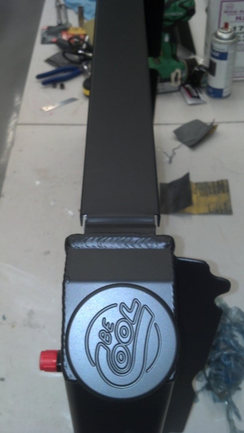

My Battery exploded a few years ago and really jacked up my radiator tank. I decided to rip it out this weekend to clean it and paint it black to go with the rest of the engine compartment.
Started by sanding with 600 grit then 1500 grit. Then I used some wax and grease removal, and then hit it with Eastwood's Aluminum Prep:
Wiped it down one more time with the wax and grease removal stuff and sprayed it with Eastwood's Radiator Satin Black. Photos don't do it justice. The paint is super nice.

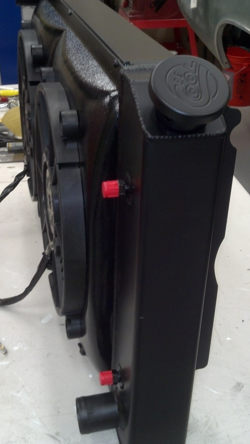

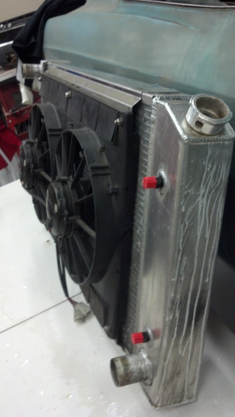

My new fans showed up yesterday from Cooling Components. Took me a while to cut the fan shroud down to fit and figure out a way to mount them since they don't come with any type of mounting brackets. Was able to tap directly into the top of the radiator, but not the bottom. Ended up modifying a bracket I had, and used two 1/4-20 rivnuts and some bolts for the bottom. Hoping the new set up will cool better than the old one. Photos attached of both new and old.
Old set up:
New set up:
Old set up:
New set up:

What brand and part number did you end up going with for the new fans? Is you aluminum radiator a stock size replacement? I'm looking for dual fans for my 73 upgrade. I have the Flex-A-Lite 420 set up on the laguna and its fits pretty good.
Re: 74Malibu383 Build
I went with part number:
CCI-1228 | 18"H X 30"W
The measurements are the outer dimensions of the shroud. These ones barely fit, but they look great and glad I went with the biggest ones he had.
I'm pretty sure it was a stock replacement, but it's been 5 years. The core of my radiator measured out at 27.5" x 17.5" if that helps at all?
