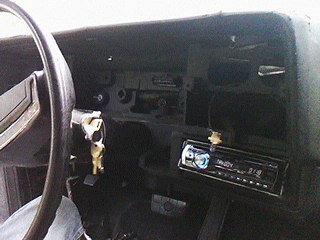

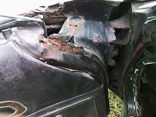

well I may have a big block in a trade in the next few weeks, so ive been pulling the inside dash out so i can get a new one and get some new gauges, need something different, not sure on what gauges I will go with but I want the bulbs to be bright and green here is some progress..
and i need a new trunk pan hahah
