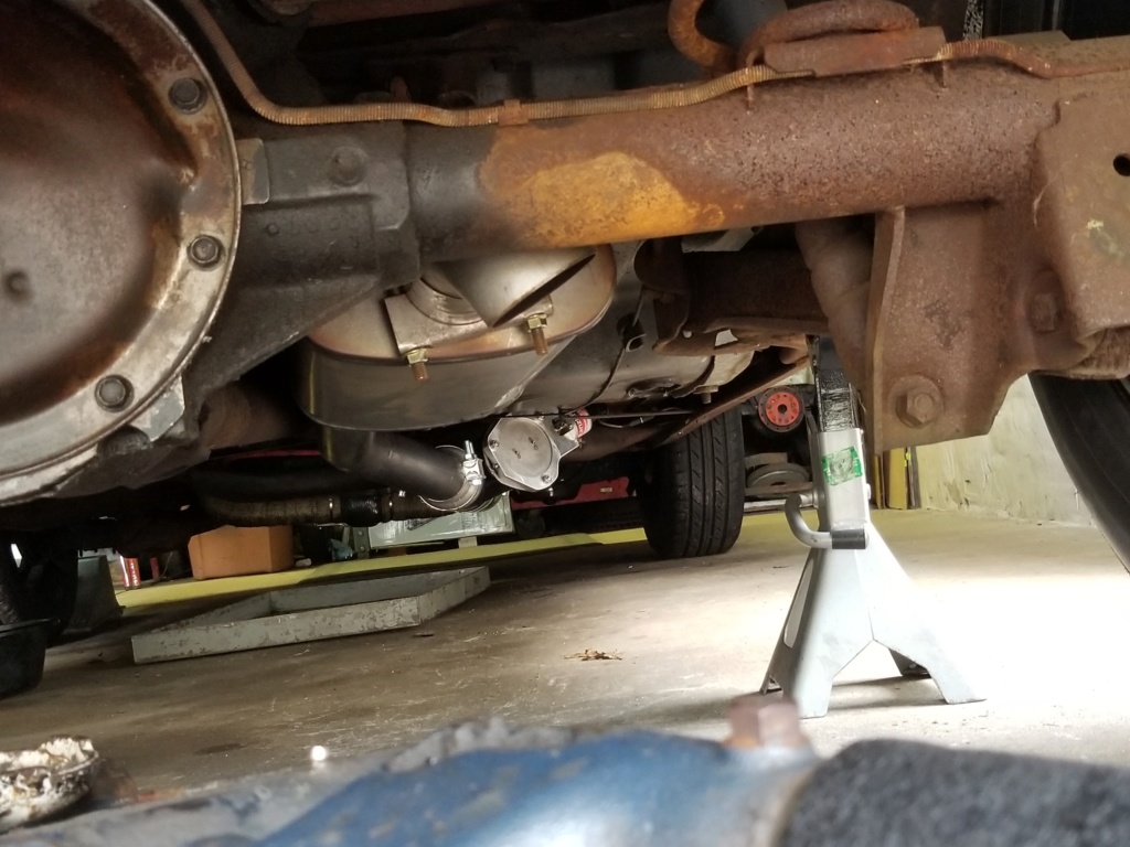

Also put a 4" electric cutout on the downpipe, then reduced it down into the single 3" exhaust that was on the car before.
Never thought 3" exhaust would look small...
2.5" vs 4"
Vid of the cutout while it was being mocked up
2.5" vs 4"
