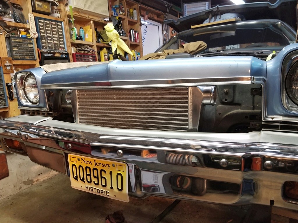

Now on to the '73, so I went and ordered a mess of parts for it
Turbo manifold
![My 73 Chevelle turbo LS swap - Page 2 2017-016](https://i.servimg.com/u/f62/14/24/94/52/2017-016.jpg)
Intercooler & turbo blanket
![My 73 Chevelle turbo LS swap - Page 2 2017-017](https://i.servimg.com/u/f62/14/24/94/52/2017-017.jpg)

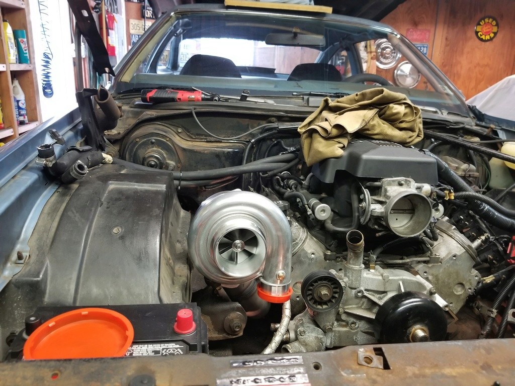

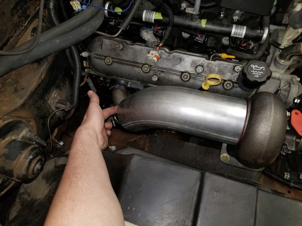

Also got a cam and valve springs for it
![My 73 Chevelle turbo LS swap - Page 2 2017-019](https://i.servimg.com/u/f62/14/24/94/52/2017-019.jpg)
Ripped the car apart and changed the cam and springs, then started mocking everything up to see what else needed to be done.![My 73 Chevelle turbo LS swap - Page 2 2017-113](https://i.servimg.com/u/f62/14/24/94/52/2017-113.jpg)
![My 73 Chevelle turbo LS swap - Page 2 2017-115](https://i.servimg.com/u/f62/14/24/94/52/2017-115.jpg)
![My 73 Chevelle turbo LS swap - Page 2 2017-114](https://i.servimg.com/u/f62/14/24/94/52/2017-114.jpg)
![My 73 Chevelle turbo LS swap - Page 2 2017-116](https://i.servimg.com/u/f62/14/24/94/52/2017-116.jpg)

Ended up having to put new motor mounts on it and space them up about 5/16" to get the turbo manifold to clear the upper control arm bolt (that I still had to grind alittle off of anyways).
![My 73 Chevelle turbo LS swap - Page 2 2017-117](https://i.servimg.com/u/f62/14/24/94/52/2017-117.jpg)

then started mocking up the intercooler![My 73 Chevelle turbo LS swap - Page 2 2017-122](https://i.servimg.com/u/f62/14/24/94/52/2017-122.jpg)
![My 73 Chevelle turbo LS swap - Page 2 2017-121](https://i.servimg.com/u/f62/14/24/94/52/2017-121.jpg)
![My 73 Chevelle turbo LS swap - Page 2 2017-120](https://i.servimg.com/u/f62/14/24/94/52/2017-120.jpg)

So then I figured that I already have a bunch of 4" mandrel bends laying around from another project that never got started, why not use them to build a 4" downpipe? Possibly not my best idea..
you dont realize how big 4" is untill you start comparing it to other things....
4" vs 2.5"
![My 73 Chevelle turbo LS swap - Page 2 2017-123](https://i.servimg.com/u/f62/14/24/94/52/2017-123.jpg)
![My 73 Chevelle turbo LS swap - Page 2 2017-126](https://i.servimg.com/u/f62/14/24/94/52/2017-126.jpg)
![My 73 Chevelle turbo LS swap - Page 2 2017-124](https://i.servimg.com/u/f62/14/24/94/52/2017-124.jpg)
![My 73 Chevelle turbo LS swap - Page 2 2017-125](https://i.servimg.com/u/f62/14/24/94/52/2017-125.jpg)
Thats all the pics I have right now, just currently waiting on some more parts while Im figuring out how to run the exhaust

Nice work! Are you concerned, though, about the heat coming off that turbo in proximity to the plastic fenderwell? I know from personal experience that they're easy to melt. Are you planning some sort of heat shield in between?
