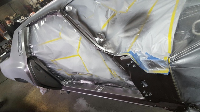

Some paint went on last night. Eventually settled on a 2004 color.

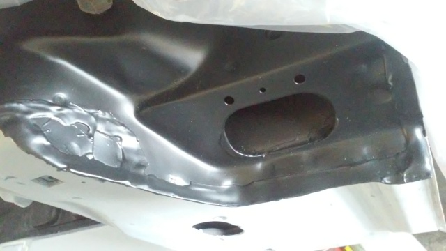

All seam sealer was replaced with Lord Fusor 129, awesome stuff. The top of the cowl was painted with John Deere Blitz black over epoxy.
73CopperMonte- G3GM Member
Re: 73 Monte LS1 4l60e swap, 4 wheel disc, project pics
Looks awesome! What is this seam sealer product?
77mali, I used Lord Fusor 129 everywhere on the Monte, top of the cowl(pictured above) doors, trunk lid, tail panel, etc. It flows out nice, but work time is 4-5 min. Designed to fill roof channels on cars where all the sheetmetal overlaps. Youtube Fusor 129 for a video.
