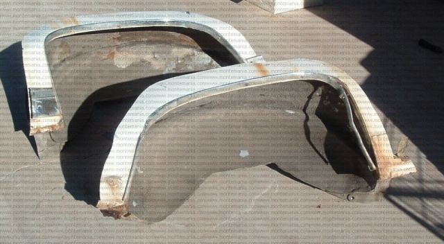

Wasted time with Phil @ MonteMania, not much help, offered me a repo LH quarter after I asked for the used LH wheelhouse pictured.Â
I have tried to deal with him a few times over the years and never works out, he tells you what you need.

So I had to buy a NOS LH wheelhouse off a great ebay seller in Canada. $304 shipped. Â Used the rear bottom 10".

73CopperMonte wrote:Wasted time with Phil @ MonteMania, not much help, offered me a repo LH quarter after I asked for the used LH wheelhouse pictured.Â
I can identify. Pricing is all over the place, too.

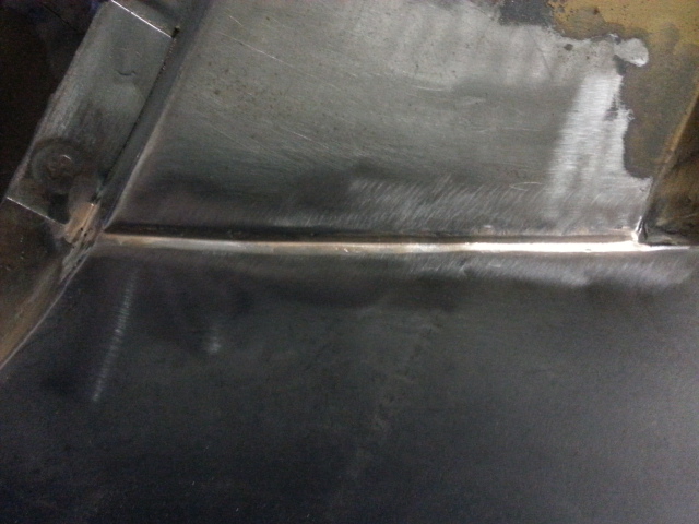

Seam from quarter panel to trunk filler was filled with silicon bronze. I wanted a factory look, did not want to weld flat and seam sealer would have possibly dried and cracked.
