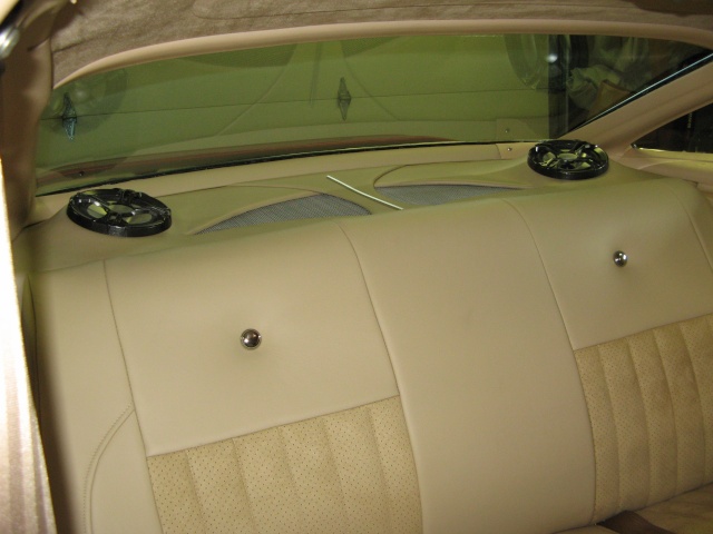

If your talking about the metal section at the bottom of the back window on my car I contact cemented leather in and cut it flush with the window by using a razor blade to cut it. That way it looked finished off and matched the interior color. You can paint it also.

Ah, thanks for the photo, Wally, now I understand what he was referring to. In mine the package tray reaches all the way to the window, so that section is not visible.
