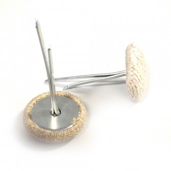

FYI...each of those upper panel buttons are held on by two spread prongs that are between the outer fabric/vinyl and cardboard backing. Don't know how you'd remove them without the risk of damage...unless you carefully cut out the cardboard backing right behind each one and squeezed the prongs together so as to pull the button off. Next time out, I'll find a damaged panel and investigate...if, for no other reason than to satisfy my curiosity.

Mcarlo77. they are called prong buttons. Here is a photo of one.
![Interior removal / update. - Page 3 <a href=](<a href=)
We (Upholstery guys) make them up from vinyl or fabric. They can be bent back straight and pushed out. Unless its really rusty you can take them on and off a few times with out breaking the prongs off. If worse thing happens and its breaks just go to a Upholstery shop and have them make you a new one. you need a 50 cent size piece of vinyl to make up the button. I cut chunks out of my old sample books that are a close match for people if they are missing one and don't have a scrap piece of vinyl.
Now you are in the know.

![Interior removal / update. - Page 3 Prong10](https://i.servimg.com/u/f38/17/24/85/08/prong10.jpg)
Wally
Re: Interior removal / update.
Wally - you are awesome. That's perfect. Now I can take the panel completely apart and and not worry about getting good coverage around the buttons, when I dye them.
