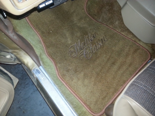

Seats in, console in place (not permanent yet, still working on kitchen) and got the new floor mats a few days ago.
You can see the slight diff in color between the console and seats/door panels here.
This REALLY shows the sun fade on the carpet. See how well the mats match near the trans tunnel, but the huge diff between the mats and the rocker side?
The mats came from Auto Custom Carpets (ACC). They were the ONLY comapny I could find that had the right color and the "Malibu Classic" embroidery.
I looked into replacing the carpet altogether, but read way too many complaints about fit.
I replaced the carpet in the Laguna and it sucked. It was lumpy and puffy around the trans tunnel, and I didn't read any reviews from any car guy that didn't say pretty much the same thing about most aftermarket carpet.
Mine isn't worn at all, and the mats go a long way toward covering most of the sun fade.

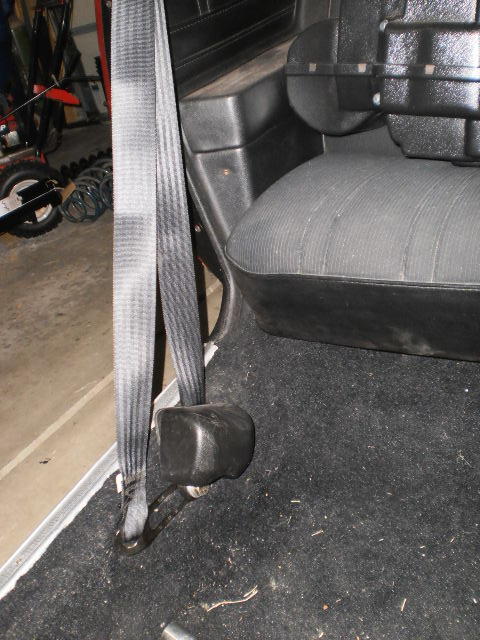

Seat belts....grrrrr.
I got a good set of factory belts from ebay, but like I said in previous post...no luck with dying.
I got great info for re-webbing from Steve and might try it but...
The swivel belts for G3s are weird compared to most other cars because of the way they mount. I don't think there are any other cars that have two separate retractors, upper and lower. Some of the eighties Camaros did, but I don't know if the upper retractor would fit properly on the roof of the G3. And you're still getting used twenty five year old belts that likely don't work anyway.
You run into problems at the lower retractor because the mounting point at the rear of the seat can interfere with the seat sliding back, since it's in the floor vs. the rocker.
I found these..."Roadster" belts from Wesco
http://www.wescoperformance.com/welr-n-retractable-install.html#top
I think these might work if I mount the retractor to the floor and the end piece to the roof.
Thoughts?
Thoughts?
Re: Roadcaptain's 77 Build Thread.
Having a 73 model means I had that PITA 2-piece arrangement with a clip on shoulder belt, so I never had dual retractors. I converted to a standard floor retractor unit and used the shoulder B-pillar mount for the strap guide, works like a typical modern arrangement.
As for the roadster belts, I used those in the back seat -- mounted them to a hard point on the back deck so the rear passengers actually have a shoulder and lap belt arrangement. Works fine.
