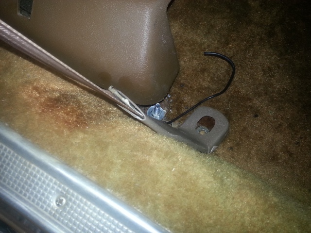

Seat belt Solution...at last!
The swivels were in and the mounting points did not work for factory swivel belts that I paid $$$ for. #*#!
Heres with the drivers seat all the way forward...note the star bolt for the seat belt base. When the seat was all the way back (like it has to be to fit my fat butt) the seat trim piece and slide rails covered the bolt. Obviously, the stock swivel belt base stopped the seat from going back far enough.
![Roadcaptain's 77 Build Thread. - Page 3 <a href=](<a href=)
I searched and read, couldn't find too much about belts anywhere.So then I posted here whining about it. Wally (bless him) said he used some Camaro belts in his ride. I poked around a bit and came up with some from a 93 Z28. Even got the right color. I THINK any belts from a 93-02 Camaro or Firebird will work, but not 100% on that. These mostly were plug and play.
This is next to the factory bench belt (chevelle top, Z28 bottom). Note that the Z28 belt does NOT have a retractor on the bottom end, just a steel plate with plastic sleeve. That's kinda important for seat clearance.
Note the roof retractors are ALMOST identical...more on that in a minute..Chevelle-red,Camaro-black
The retractor bolted right up to the roof, BUT the cover wouldn't allow the belt to slide in and out. I had to trim the cover just a little bit to allow for proper install. You can see it here:
The floor mount bolted right in, as did the female side of the belt. I was even able to leave the sleeve intact since it bent enough to allow the seat to slide back.
Seat forward:
Seat all the way back:
So there it is, problem solved...nearly drove me bat****. If you want to update your belts to something a little newer, or if you've swapped out the bench or if you just want that damn stock retractor out of the middle of the floor, look for 93-02 Camaro or firebird belts.
Now I have to figure out how to get some guides on without tearing up the seats...Wally?
![Roadcaptain's 77 Build Thread. - Page 3 Seatbe10](https://i.servimg.com/u/f19/14/01/57/47/seatbe10.jpg)
![Roadcaptain's 77 Build Thread. - Page 3 Seatbe11](https://i.servimg.com/u/f19/14/01/57/47/seatbe11.jpg)
![Roadcaptain's 77 Build Thread. - Page 3 Seatbe12](https://i.servimg.com/u/f19/14/01/57/47/seatbe12.jpg)
![Roadcaptain's 77 Build Thread. - Page 3 Seatbe13](https://i.servimg.com/u/f19/14/01/57/47/seatbe13.jpg)
Seat forward:
![Roadcaptain's 77 Build Thread. - Page 3 Seatbe14](https://i.servimg.com/u/f19/14/01/57/47/seatbe14.jpg)
![Roadcaptain's 77 Build Thread. - Page 3 Seatbe15](https://i.servimg.com/u/f19/14/01/57/47/seatbe15.jpg)
![Roadcaptain's 77 Build Thread. - Page 3 Seatbe16](https://i.servimg.com/u/f19/14/01/57/47/seatbe16.jpg)
![Roadcaptain's 77 Build Thread. - Page 3 Seatbe18](https://i.servimg.com/u/f19/14/01/57/47/seatbe18.jpg)
Last edited by Roadcaptain S3 on Wed Apr 15, 2015 6:16 pm; edited 4 times in total

calm down buddy. gm uses the same hole for the bracket that holds the back leg of the swivel. than they put another hole for the seat belt. please see pics
driver side- left bolt would be stock location for a bench seat retractor. right bolt is factory location for bucket seat retractor
![Roadcaptain's 77 Build Thread. - Page 3 01610](https://i.servimg.com/u/f19/15/58/92/08/01610.jpg)
seat is all the way forword
![Roadcaptain's 77 Build Thread. - Page 3 01710](https://i.servimg.com/u/f19/15/58/92/08/01710.jpg)
seat is all the way back
![Roadcaptain's 77 Build Thread. - Page 3 01810](https://i.servimg.com/u/f19/15/58/92/08/01810.jpg)

Hmmm. Maybe different for 77 or a bench seat car?
My car doesn't have the right hand hole.
Either way, kinda like the camaro belts better. Cheaper too.

I've poked around on the vinyl and can't feel anything in the normal area to mount to. I THINK these seats may be from a 73 without the shoulder belt. I can feel the upper edge of the seat and may try mounting them there.
As it is, the shoulder belts cuts across high and at a weird angle like you can see in the pic.
I might have some retainers...I'll check the pile and pm you.
Re: Roadcaptain's 77 Build Thread.
Do a Google image search for the seats to see the location for them in general they are down the side a bit.
