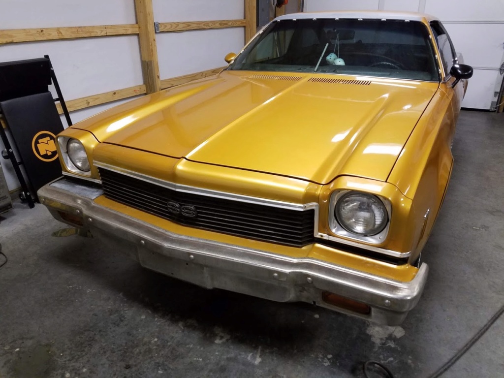

Update: Investigating for a vacuum leak, I plugged the brake booster hose, no change. Plugged PCV, no change. I thought oh no, the intake must be leaking. Then I thought, let me check the carb linkage again. Disconnected linkage, engine died. Turned the idle screw, restarted, problem solved. So the butterflies in the carb not being aligned was the problem, but after fixing that, I didn't check the linkage again and down the rabbit hole I went.
 The engine runs strong and I couldn't be happier with it considering how many hundred dollar bills are in it, or the lack thereof. I'm guessing it's making close to 400hp. It skitches the tires shifting to second which is something I thoroughly enjoy. I finally dealt with the front bumper, installed the missing filler and tucked it about an inch. Looks good, just needs paint or chrome.
