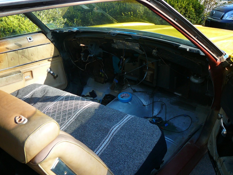

Busy day today...Roof rails & trim trial fit + getting the engine bay ready. Pulled out all the harnesses, including the dash harness. All that's left in there are the intermediate from the trunk, the dome lamp stuff & the vacuum lines. Pulled off some more stuff that needs painting including the steering column (again).
Tossed the bench back in too to make room in my small shop
If this damn car is not on the road by the end of this summer...I'm going to go APE
