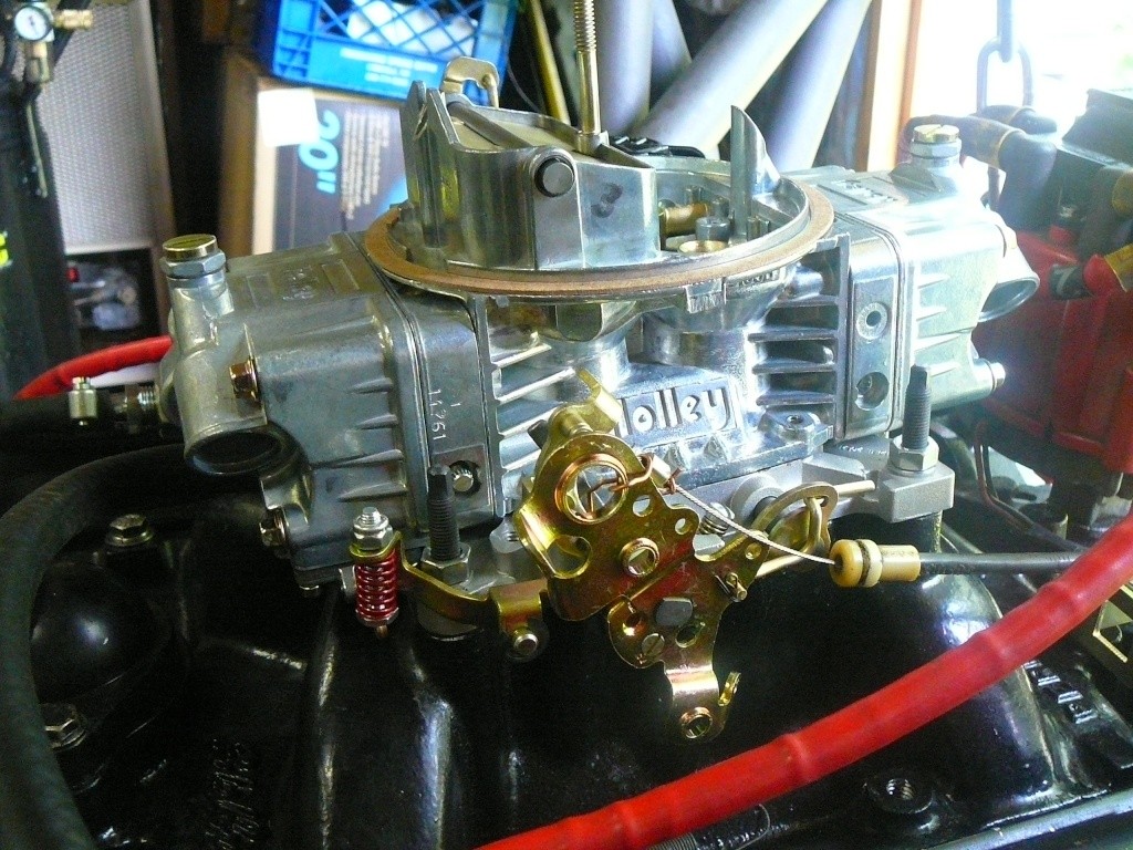

Re: 1977 Chevelle Malibu Classic Progress Photo's aka Mali
Here's a couple more pics of the Carb.
I hooked up the electric choke like this temporarily direct to the fuse box which is off the car w/ the column (black wire in the "ACC" slot). Really made it easy to do it this way. The pink pin is to light up the Tach w/ the ignition on.
I have to reroute the fuel line too it's a bit Mickey Mouse for now but functional. I have the old metal line & plan to reuse that or maybe get one of those mechanical pumps that will allow you to "turn" the line. Fuel pressure was right around 7.5 psi and this little filter is nice too as you can see the fuel unlike the metal one which I had on the Q Jet set up.
I ran plastic fuel line on my car (the same kind used on some new cars). The line from the pump to the carb is plastic also (covered with aluminum insulation) with quick releases at both ends..ie the line can be removed with no tools in about 3 seconds. For a filter I put a new car style inline filter (again with quick releases) over the rear end.
